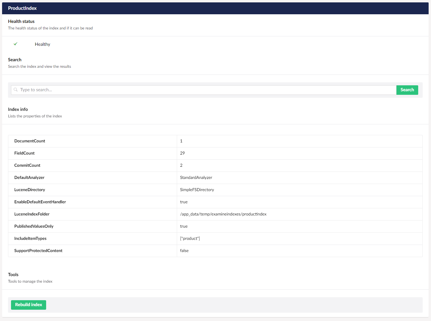

            // Noticed that we return a collection of indexes? Technically you
            // can create multiple indexes in an indexCreator :) You can have a look at
            // UmbracoIndexesCreator.cs in the CMS core and see how the CMS does that.
            public override IEnumerable<IIndex> Create()
                var index = new UmbracoContentIndex("ProductIndex",
                    CreateFileSystemLuceneDirectory("ProductIndex"),
                    new UmbracoFieldDefinitionCollection(),
                    new StandardAnalyzer(Version.LUCENE_30),
                    _profilingLogger,
                    _localizationService,
                    // We can use the ContentValueSetValidator to set up rules for the content we
                    // want to have indexed. In our case we want published, non-protected nodes of the type "product".
                    new ContentValueSetValidator(true, false, _publicAccessService, _scopeProvider, includeItemTypes: new string[] { "product" }));
                return new[] { index };

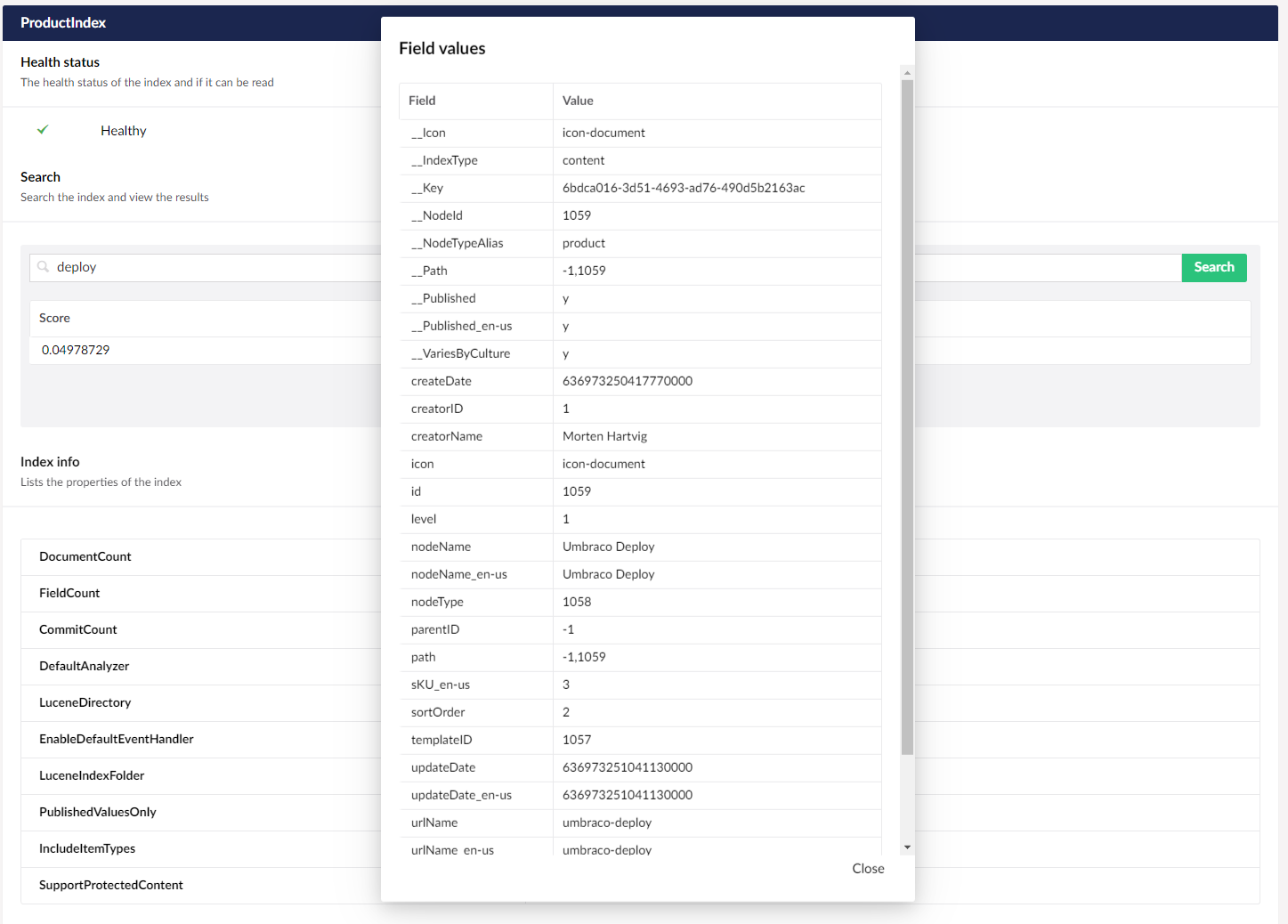

    You can create an IValueSetBuilder implementation that builds the value sets .
    ProductIndexValueSetBuilder
    using Examine;
    using Umbraco.Cms.Core.Models;
    using Umbraco.Cms.Infrastructure.Examine;
    namespace Umbraco.Docs.Samples.Web.CustomIndexing
        public class ProductIndexValueSetBuilder : IValueSetBuilder<IContent>
            public IEnumerable<ValueSet> GetValueSets(params IContent[] contents)
                foreach (var content in contents)
                    var indexValues = new Dictionary<string, object>
                        ["name"] = content.Name,
                        ["id"] = content.Id,
                    yield return new ValueSet(content.Id.ToString(), "content", indexValues);
    You can also create an IndexPopulator implementation that populates the index with the value sets.

    Result
    Custom product index
    Product document
