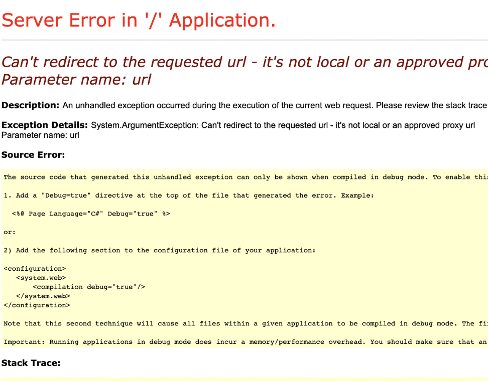

    Hi, We have hosted our Umbraco application on Azure using Azure App Service. Application was running fine but after some days it crashed unexpectedly. After restarting the app it was again running fine but now, it crashed again after about 14 hours. We are using Umbrco 7.6.0. Following is the screenshot of the error we get: umbraco-app-crash
    Stack trace is below:
    System.Web.HttpUnhandledException (0x80004005): Exception of type 'System.Web.HttpUnhandledException' was thrown. ---> System.ArgumentException: Can't redirect to the requested url - it's not local or an approved proxy url Parameter name: url at ASP.configsplashesbootingaspx.Rendercontrol1(HtmlTextWriter w, Control parameterContainer) at System.Web.UI.Control.RenderChildrenInternal(HtmlTextWriter writer, ICollection children) at System.Web.UI.Control.RenderChildren(HtmlTextWriter writer) at System.Web.UI.Page.Render(HtmlTextWriter writer) at System.Web.UI.Control.RenderControlInternal(HtmlTextWriter writer, ControlAdapter adapter) at System.Web.UI.Control.RenderControl(HtmlTextWriter writer, ControlAdapter adapter) at System.Web.UI.Control.RenderControl(HtmlTextWriter writer) at System.Web.UI.Page.ProcessRequestMain(Boolean includeStagesBeforeAsyncPoint, Boolean includeStagesAfterAsyncPoint) at System.Web.UI.Page.HandleError(Exception e) at System.Web.UI.Page.ProcessRequestMain(Boolean includeStagesBeforeAsyncPoint, Boolean includeStagesAfterAsyncPoint) at System.Web.UI.Page.ProcessRequest(Boolean includeStagesBeforeAsyncPoint, Boolean includeStagesAfterAsyncPoint) at System.Web.UI.Page.ProcessRequest() at System.Web.UI.Page.ProcessRequestWithNoAssert(HttpContext context) at System.Web.UI.Page.ProcessRequest(HttpContext context) at ASP.configsplashesbootingaspx.ProcessRequest(HttpContext context) at System.Web.HttpApplication.CallHandlerExecutionStep.System.Web.HttpApplication.IExecutionStep.Execute() at System.Web.HttpApplication.<>cDisplayClass2850.0.
    I cannot understand why is this exception occurring or how can I get to its details.

    According to your error screenshot. you have to write debug=true in your webconfig file.
     <compilation  debug="true"  targetFramework="4.6.1" ... >

    Setting Debug=true will only provide more error details. Since you also pointed out that Debug=true will generates more cache URL, I cannot set this to true on live environment. That is why I have attached stack-trace of this error.
