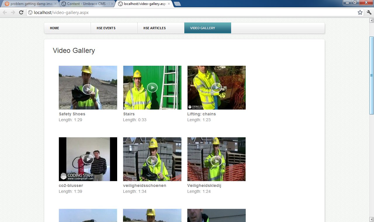

I must say, DAMP is a great package, lately I created a video gallery using FlowPlayer and DAMP to select videos. It worked out really well and I will blog about it in the near future.

The advantage of a crop is that if you give it a height and width it will always have that size. If you have multiple images which all have a diffent width and height they will still look the same. For example this website uses DAMP for the photo gallery. As you can see the width and height is always good because it's cropped. If the user wants a different part of the image to be visible he can go to the media section and drag the crop to select it.
I also use custom media folders for the same reason you described. If you use my custom version of MFU you can also only select the media types which are allowed.
Jeroen

Thanks for your explanation. So you mean a crop has always the same width and height, wherever it's used, while an image resized with imageGen only has the appropriate width and height where it is defined in the code?
I have used imageGen for this video gallery to resize all images to a same width and height (see screenshot below)
the code for this video-gallery looks like this:

So I don't know why I should use crops instead of just resizing the thumbnails with imageGen. The only advantage of using crops in this particular case is that the user has some more control over the output of the thumbnails.
greetings,
Anthony
If you use a crop in this example the images will look better. Now they are all stretched. The original images probably look better and if you use crops these images will look the same as the original images.
Jeroen
