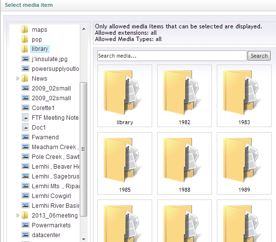

I'm also having issues with nodes missing in DAMP. Umbraco 6.1.1, DAMP 2.5.
First screenshot shows in the Media UI, the Library folder has lots of items (subfolders) within.
But using the DAMP control on a content node (2nd screenshot), there's initially a little "expand" triangle to the left of the Library node, but when you click the triangle, it just disappears and doesn't expand the library folder.
You can click the library folder which then lists the contents to the right, but you can't click any of those subfolders to get further descendant nodes.
It also incorrectly lists itself as its own child (there is no library/library folder, first entry should be 1982).
