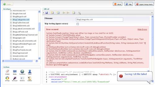

  • Tracey Munro 7 posts 27 karma points
    Jan 20, 2011 @ 15:00
    Tracey Munro
    Hi there,
    I see this topic is a bit old, but thought I'd try anyway.  I'm brand new to Umbraco so please excuse me if I say something silly.  I'm using Umbraco v 4.5.2 and I've just installed the Blog4Umbraco_2.0.26_for_4.5.zip package. The installation went fine and I can create a new blog post with no errors, but when I try to preview /blog I get the standard blog skin but with errors:
    Error parsing XSLT file: \xslt\BlogRssFeedLink.xslt
    Error parsing XSLT file: \xslt\Blogpages.xslt
    Error parsing XSLT file: \xslt\BlogCategories.xslt
    Error parsing XSLT file: \xslt\BlogLatestComments.xslt
    If I go to the developer section and try to save any of those xslt files I get an error message:
    Error occured
    System.OverflowException: Value was either too large or too small for an Int32.
    at System.Convert.ToInt32(Double value)
    at System.Convert.ChangeType(Object value, Type conversionType, IFormatProvider provider)
    at System.Xml.Xsl.Runtime.XmlQueryRuntime.ChangeTypeXsltArgument(XmlQueryType xmlType, Object value, Type destinationType)
    at System.Xml.Xsl.Runtime.XmlQueryContext.InvokeXsltLateBoundFunction(String name, String namespaceUri, IList`1[] args)
    at (XmlQueryRuntime {urn:schemas-microsoft-com:xslt-debug}runtime)
    at Root(XmlQueryRuntime {urn:schemas-microsoft-com:xslt-debug}runtime)
    at System.Xml.Xsl.XmlILCommand.Execute(Object defaultDocument, XmlResolver dataSources, XsltArgumentList argumentList, XmlWriter writer, Boolean closeWriter)
    at System.Xml.Xsl.XmlILCommand.Execute(IXPathNavigable contextDocument, XmlResolver dataSources, XsltArgumentList argumentList, XmlWriter results)
    at System.Xml.Xsl.XslCompiledTransform.Transform(IXPathNavigable input, XsltArgumentList arguments, TextWriter results)
    at umbraco.presentation.webservices.codeEditorSave.SaveXslt(String fileName, String oldName, String fileContents, Boolean ignoreDebugging)
    As reccommended, I've checked the /config/xsltExtensions.config file and it seems alright:
      <ext assembly="umbraco.editorControls" type="umbraco.editorControls.tags.library" alias="tagsLib">
      </ext>
      <ext assembly="Umlaut.Umb.Blog" type="Umlaut.Umb.Blog.BlogLibrary" alias="BlogLibrary">
      </ext>
    I've compared my xslt files to some of the suggestions people have made, but I seem to have the newest version already, unless I've missed something.
    I've tried uninstalling and reinstalling different versions but same problems.  Any ideas where to go from here?
    Thanks kindly!
    Jan 27, 2011 @ 19:07
    Tracey Munro
    I've tried uninstalling and reinstalling Blog4Umbraco_2.0.26_for_4.5 again today but same result.
    A bit more info, in case it's useful:  Here's what the blog page looks like immediately after install:  "Error parsing XSLT file: \xslt\BlogCategories.xslt" etc
    If I go to one of the blog xslt files and try to save it as-is I get this error: "System.OverflowException: Value was either too large or too small for an Int32."
     (I've tried ticking "Skip Testing" which saves the file, but the page still doesn't display properly)
    In this case, if I hard code the xslt to go straight to the node id of the blog (ie, change "$currentPage/ancestor-or-self::Blog/@id" to "2978") then this gets rid of the error and this particular xslt appears to work.
    However I tied going through all the xslt files and making the same change but some of them are a bit more complicated than that.  Is this my only option?    Has anyone else had the same experience and managed to solve it?
    I'm using Umbraco v 4.5.2 Pro with Courier and Contour, I'm running multiple websites on one instance of Umbraco and I'm using Safari v 4.0 as a browser if this makes any difference.

  • Kevin Farrow 46 posts 67 karma points
    Jan 27, 2011 @ 22:07
    Kevin Farrow
    To stop the error  "System.OverflowException: Value was either too large or too small for an Int32." you need to test the variable. For example, I usually test using an if statement - something like this:
    <xsl:if test="$blogRoot &gt; 0">
    </xsl:if>
    Note that your code will work fine if you "Skip testing" (as long as there isn't a real error!) . As you found out, if you hard code the value it doesn't complain.
    Jan 28, 2011 @ 17:28
    Tracey Munro
    SUCCESS!
    My blog *seems* to be working now, so I thought I'd share my solution in case it's helpful to anyone else.
    I made a few minor changes to the XSLT files (thanks for the advice!) which fixed the XSLT errors on save, but the blog still wans't displaying correctly.  As I mentioned, I'm running multiple websites on one instance of Umbraco, using domains to differentiate between them.  So I added a new subdomain blog.mywebsite.com and pointed it to my web server, set up the new domain in IIS, then added the new domain in Umbraco by clicking on "Blog" and selecting "Manage Hostnames".  Viola!  The blog started working straight away.
    I feel a bit silly because I really should have figured that out a while ago, but at least it's working now.  :)  Now I'm off to have a play and see if I can break something else, tee hee.  :P  Thanks again for your help!!
