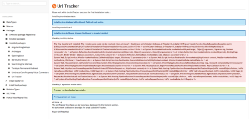

    I've just installed the newest version of Umbraco (7.2.5) and Url Tracker (3.7), and it's failing on the Http Module check:
    I've tried with 3.6, 3.5, and 3.4, but they're failed too. 3.3 worked though.

    The issue is exactly as mentioned in the stacktrace; the hostname 'xton.win.local' cannot be resolved by the server.

    You're right. The Http Module check works on a public server, but the package still don't work. Now it just returns 404. I've tested with 3.3, and there it works perfectly.
