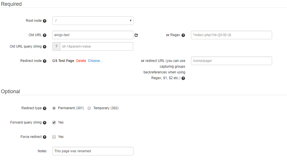

    I have enabled logging and I get this:
        2018-06-07 11:52:41,728 [P5076/D3/T309] DEBUG InfoCaster.Umbraco.UrlTracker.Helpers.LoggingHelper - UrlTracker HttpModule | EndRequest start
     2018-06-07 11:52:41,728 [P5076/D3/T309] DEBUG InfoCaster.Umbraco.UrlTracker.Helpers.LoggingHelper - UrlTracker HttpModule | Incoming URL is: en/gs-test/?1
     2018-06-07 11:52:41,728 [P5076/D3/T309] DEBUG InfoCaster.Umbraco.UrlTracker.Helpers.LoggingHelper - UrlTracker HttpModule | Response statusCode is 404, continue URL matching
     2018-06-07 11:52:41,733 [P5076/D3/T309] DEBUG InfoCaster.Umbraco.UrlTracker.Helpers.LoggingHelper - UrlTracker HttpModule | Current request's rootNodeId: 1057
     2018-06-07 11:52:41,743 [P5076/D3/T309] DEBUG InfoCaster.Umbraco.UrlTracker.Helpers.LoggingHelper - UrlTracker HttpModule | No match found, logging as 404 not found
     2018-06-07 11:52:41,746 [P5076/D3/T309] DEBUG InfoCaster.Umbraco.UrlTracker.Helpers.LoggingHelper - UrlTracker HttpModule | EndRequest end
    The original node name was "GS Test" giving a Url of "/en/gs-test". The new name is "GS Test Page" with a Url of "/en/gs-test-page".
    The Url Tracker settings are: enter image description here
    But when these get created, the Url dropdown always seems to select the second item, rather than the last one which is actually the first domain entered against the top-level node. Changing it to either the last item or to "\" seems to have no effect. enter image description here

    Okay, so on the root node drop down are you able to select the node with the ID of 1057?
  • Gordon Saxby 1271 posts 1498 karma points
    Jun 07, 2018 @ 13:31
    Gordon Saxby
    The 4 items that start "en" are node 1057. Whatever I select there has no effect.
    The "./en/gs-test" request is being logged in the "404" list - if I edit that and point it at "/en/gs-test-page" then it works. Of course, I don't want to have to do that manually for every changed page!
