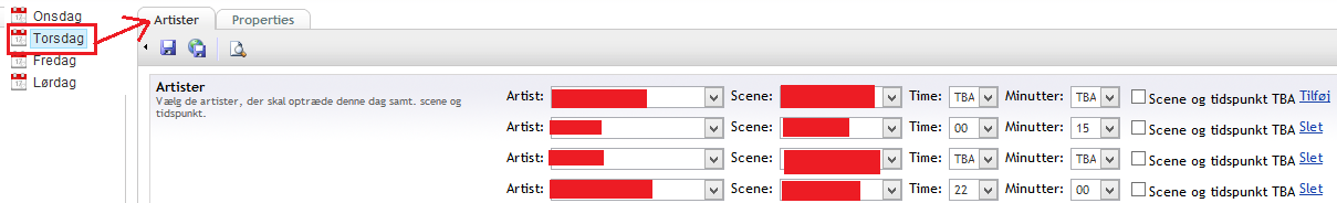

I hear what you're saying about assigning all times to a date (and yes, musicians are lazy chaps! ;-)) Thing is, they want it to be as "open", flexible and loosely coupled as possible when making the program. Got a screenshot for you of my structure and datatype (don't mind the design of it though, it's not done yet :-D):
Having it like this, they are completely free to make the program, like they want, without limitations. Sorting it, however, is quite a challenge :-) But I think you are right, they would expect it to be auto-sorted when output on the page, so I have to figure out a way to do that.
