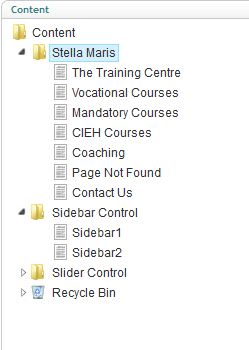

The thing is, your sidebarNode variable actually selects all the level 1 nodes ("Stella Maris", "Sidebar Control" & "Slider Control") because the selector goes through currentPage and all its ancestors, selecting all of their children, then filtering by the level attribute.
The only reason the for-each grabs the right nodes is because you have no Sidebars documents as children of neither "Stella Maris" nor "Slider Control"...

The content structure:
As I mentioned, the sidebars show on the homepage (Stella Maris node) but not on the internal pages
