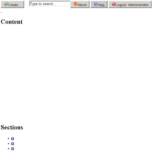

I need a little help. I installed Umbraco a control panel known as DotNetPanel. Everything went great but after logging in as admin, very little was rendered in the dashboard. The four buttons appear but clicking on them does nothing. The only other things rendered was the text "Content" and "Sections" and six links under the "Sections" area (please see attached). I am guessing there is an issue with my permissions as no styling or script is running, but after checking my permissions for the "umbraco" directory, they seem okay:
NETWORK SERVICE: Read/Execute, list Contents, Read
USERS: Full Control
Practically every other group has full control. Is it my permissions or something else? I appreciate any help in advance!
USERS: Full Control

i have seen this when having the wrong settings on the app pool... if you are using classic, try integrated pipeline... if using integrated... try classic... off the top of my head, i cannot remember which direction it goes :)
hope that at least helps a bit.
I have had this with bad ASP.NET installs/configurations. So i think thats definitly it. And I totally agree with bob baty-barr
@bob
Yeah that was it! Looks good. Thanks for your help!
