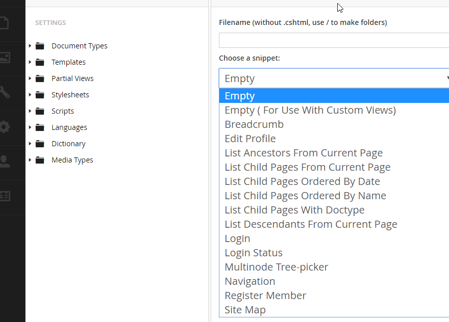

How are you creating members?
Make sure to use the
MemberService: https://our.umbraco.org/Documentation/Reference/Management/Services/MemberServiceExamples are available in snippets when you create new partial views in the backoffice.
I was trying to create server side using surface controller...
Yes, the code is still C#, it's just an example.. :-) Use it in your controllers!
Excellent - got Login and Registration working!!!
