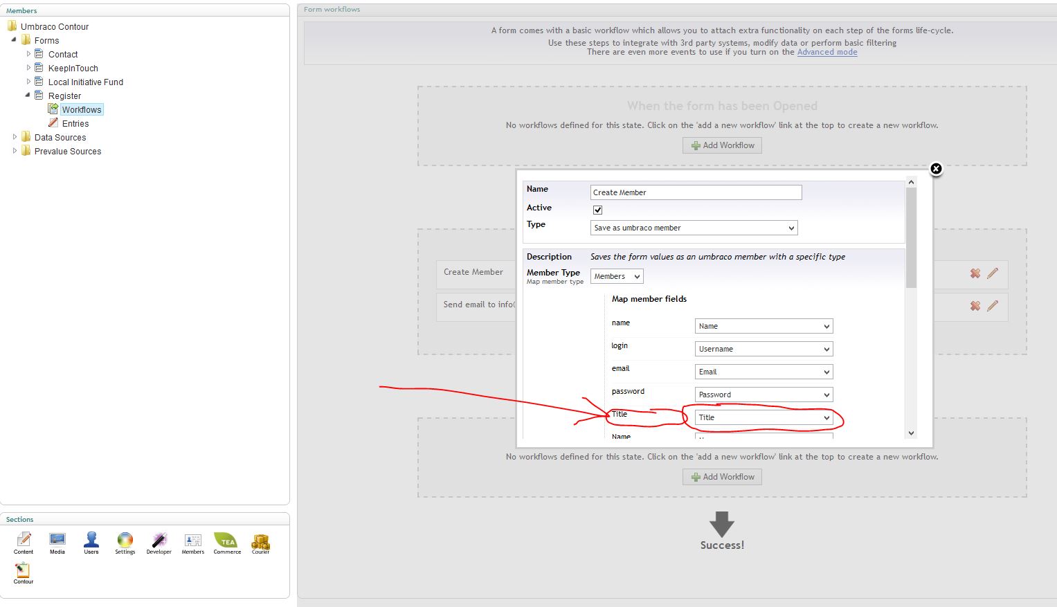

    Im creating a Register/Membership sign up form with extra properties.
    I can map the textstring values to the propertys not a problem. What im having trouble doing is binding the drop down values.

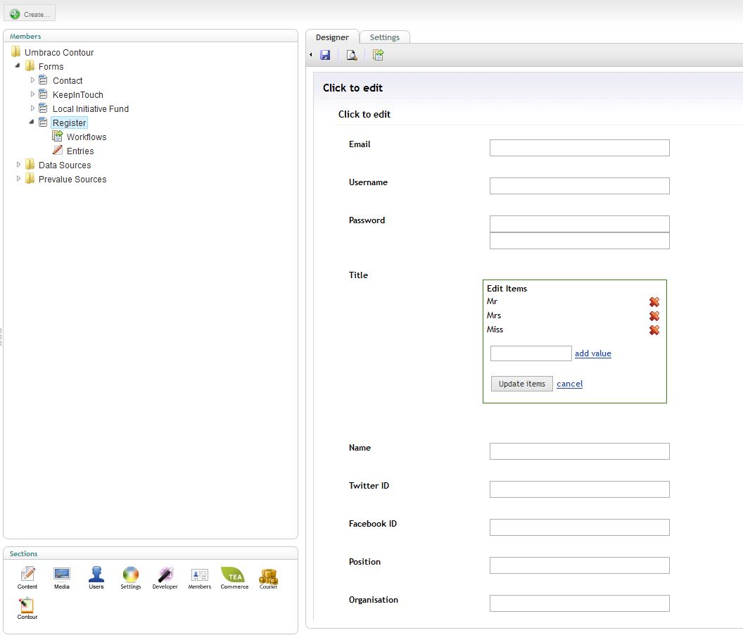

    Above are is the Title drop down with the values, Mr, Mrs and Miss
    As you can see on the workflow of the form im binding the Title to the Title Drop down

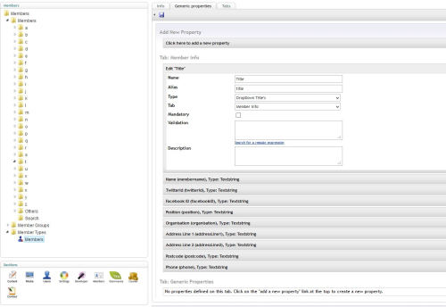

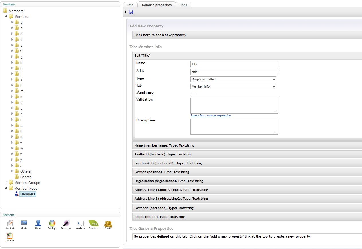

    Above are the Members properties, with the Title drop down using my Custom DataType i created that is a drop down with the values Mr, Mrs and Miss

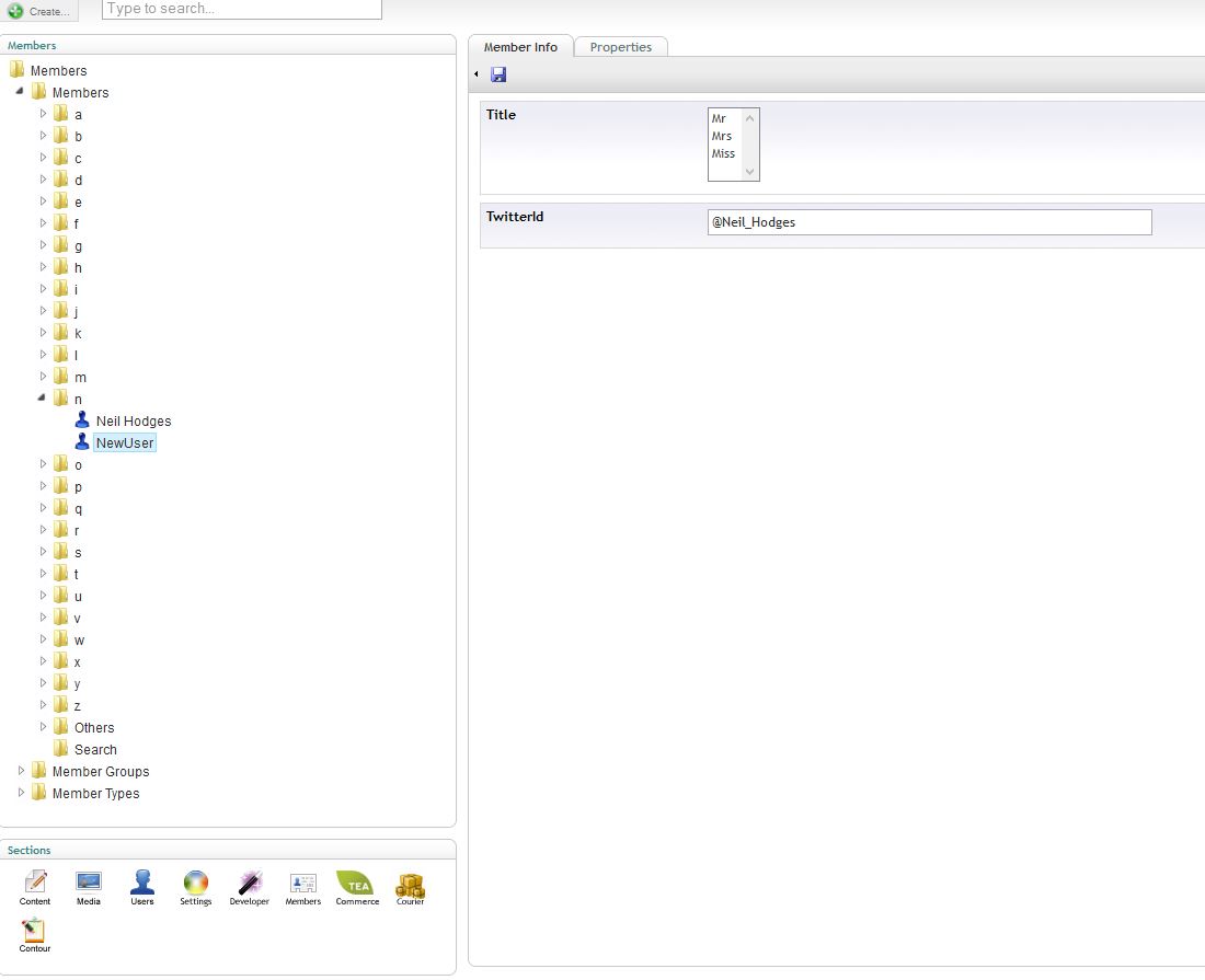

    When the form is submitted i get all the other mapping ok, it inserts the values for the textstrings but not the Title?
    There must be something simple i am missing but cant see what, can any one help?

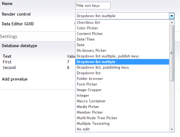

    Could you download https://dl.dropbox.com/u/886345/UpdateProviders.zip then unzip and place that in your bin directory (overwriting the existing ones).

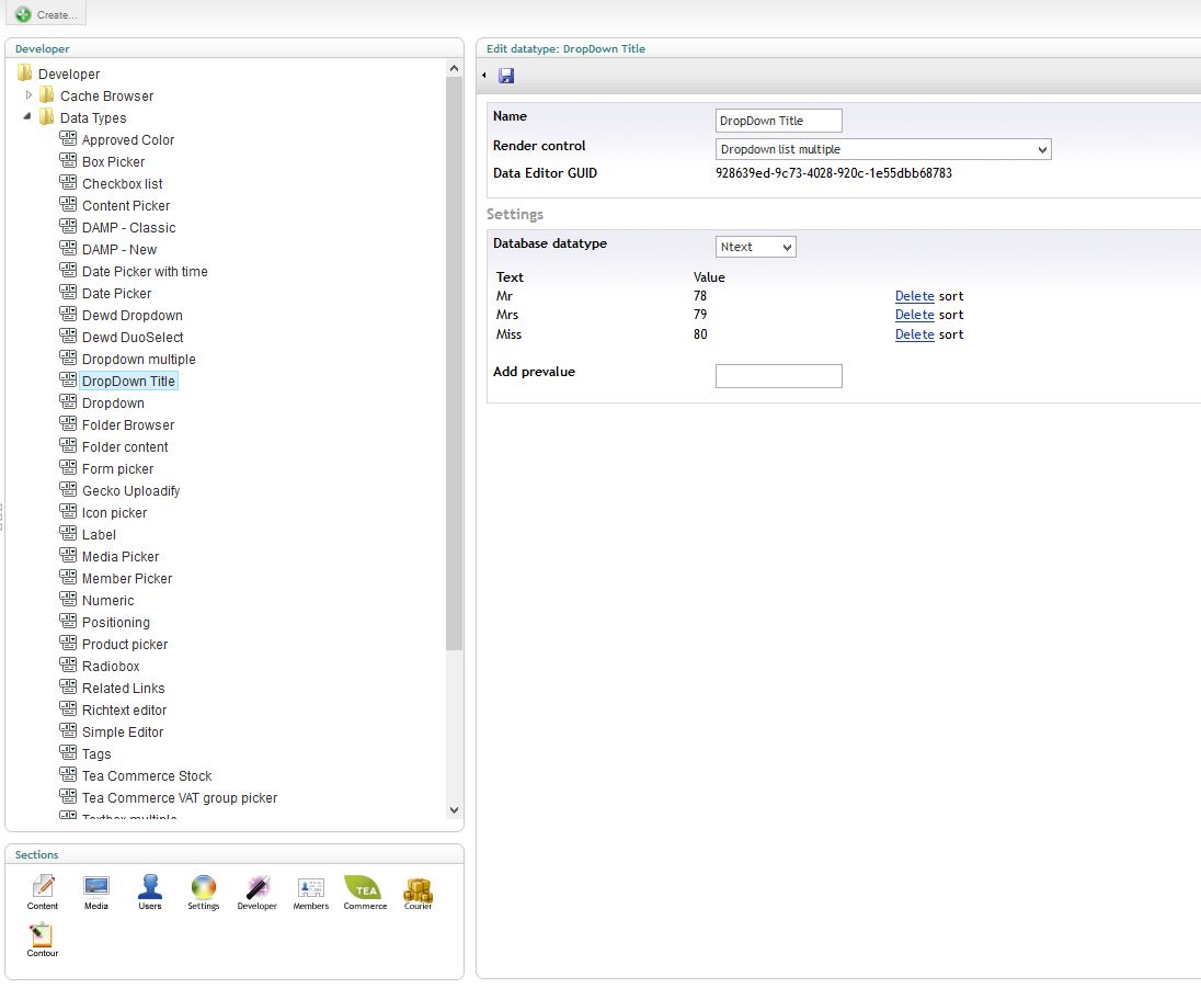

    Also make sure in your title datatype you are using the render control 'dropdown list multipe' (so not the one with publishing keys)
    See attached screenshot
    Let me know if that does the trick (so register a new member and see if it works now)

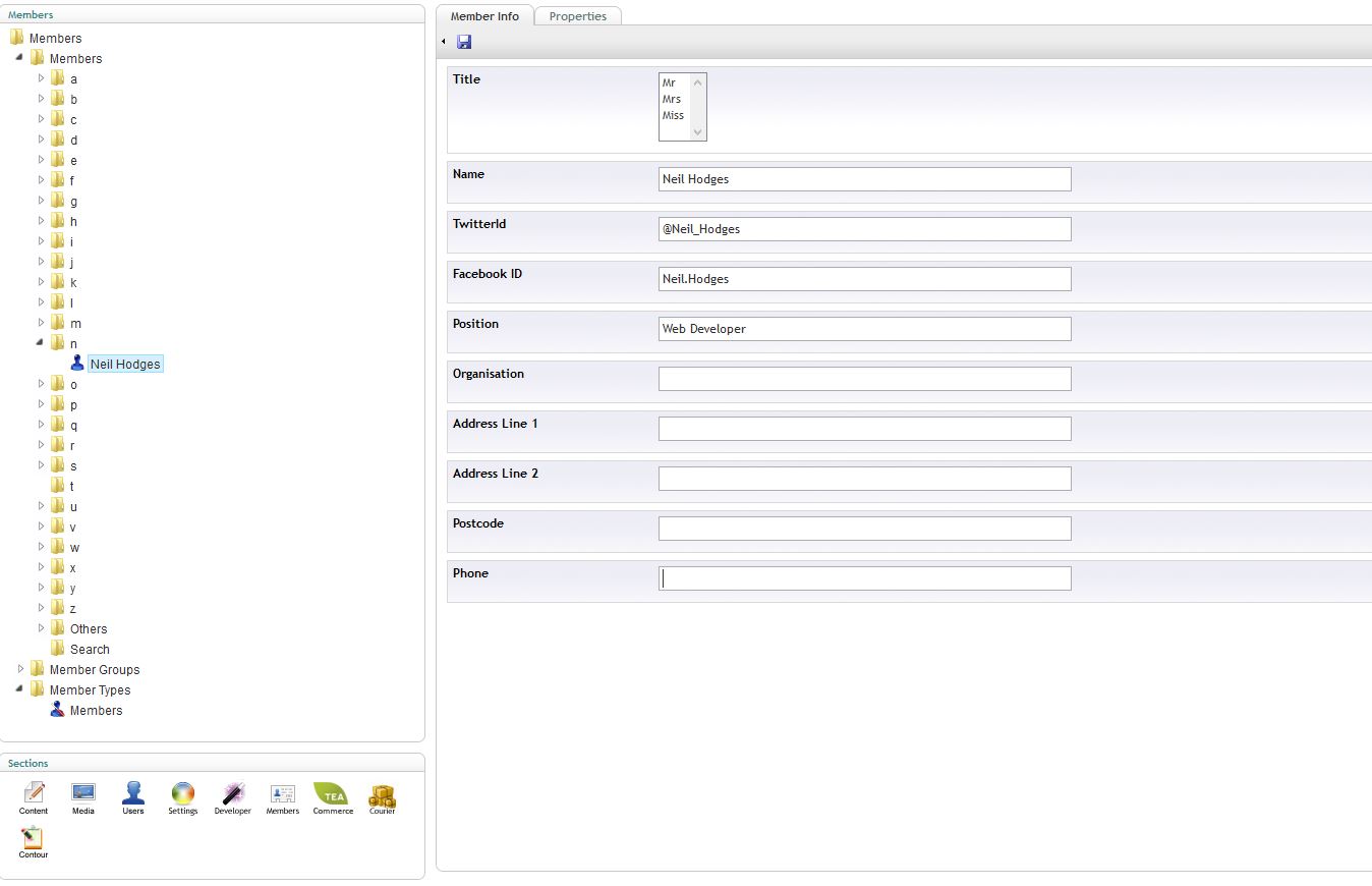

    Thanks for the quick response. I have applied the new dll file into the bin folder and tested registering a new member but still doesnt seem to select the correct drop down for title.
    please see below
    I have made sure the custom DataType is using 'Dropdown list multiple'
