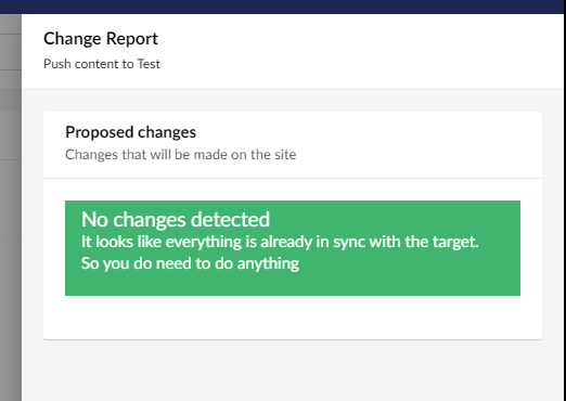

    uSync Publisher not working
    uSync publisher: No changes detected It looks like everything is already in sync with the target. So you do need to do anything
    When i publish a page to our test environment i get the message below. I get this message with a new page and with a modified page.

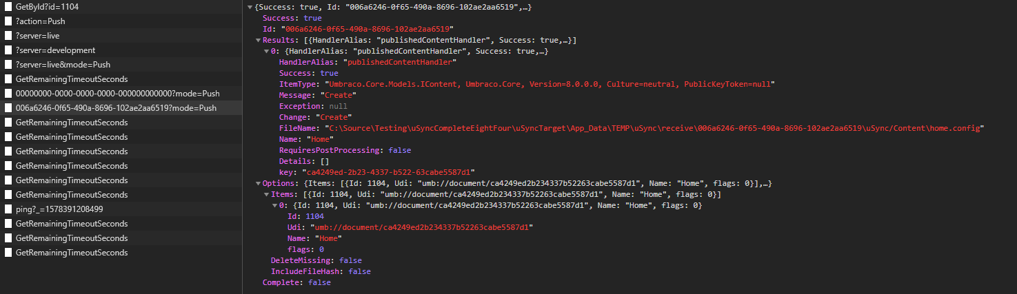

    also if you are using uSync.Complete v8.4 ? can you check to see what is coming back in chrome inspector? there will be a peformaction call that should return the results of any changes, it would be good to see what was in that response.
    example response from a site - this shows one item - being created on a site

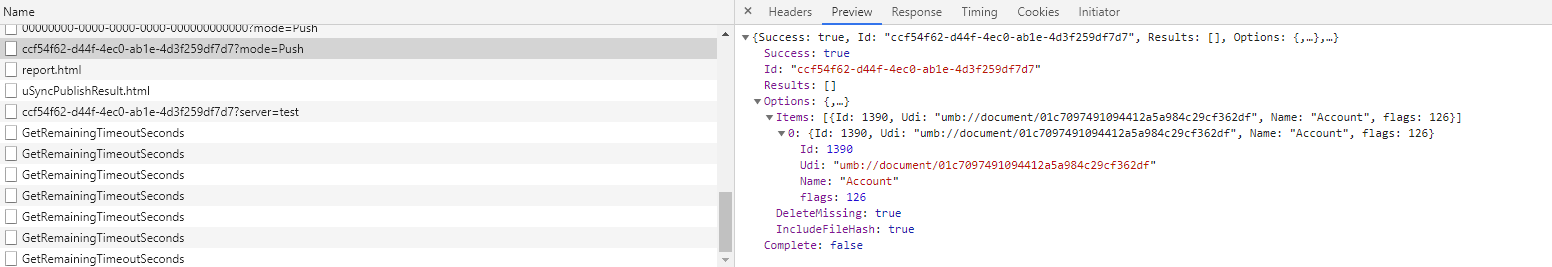

  • Nico 4 posts 85 karma points
    Jan 07, 2020 @ 10:23
    Nico
    Yes, the test server has its own DB.
    We use uSync.Complete 8.4.1
    The results tag is empty.
