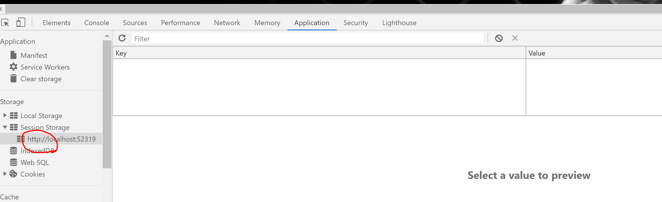

    2. When I look in Chrome inspector I can see the url in the session section but there is no keys or variables at all.

    I tested some more. Mainly in different browsers. This just seems to be a Chrome thing.

    It may have been a bug with Chrome.
    I cleared all the cookies and history in Chrome and I cant seem to re-create the issue.
    Hopefully that's the end of it.
