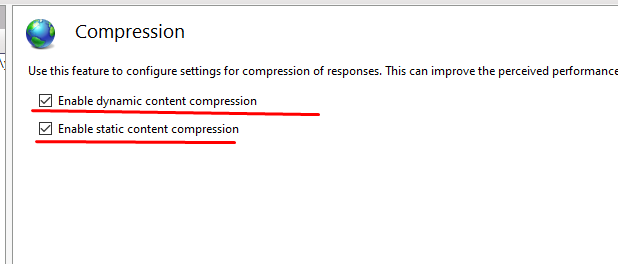

  • Yakov Lebski 594 posts 2350 karma points
    Aug 27, 2020 @ 15:34
    Yakov Lebski
    Check what both enabled enter image description here

  • lori ryan 239 posts 573 karma points
    Aug 27, 2020 @ 16:02
    lori ryan
    on the server I cant enable dynamic is greyed out so I dig a little deeper thanks so much for the help
