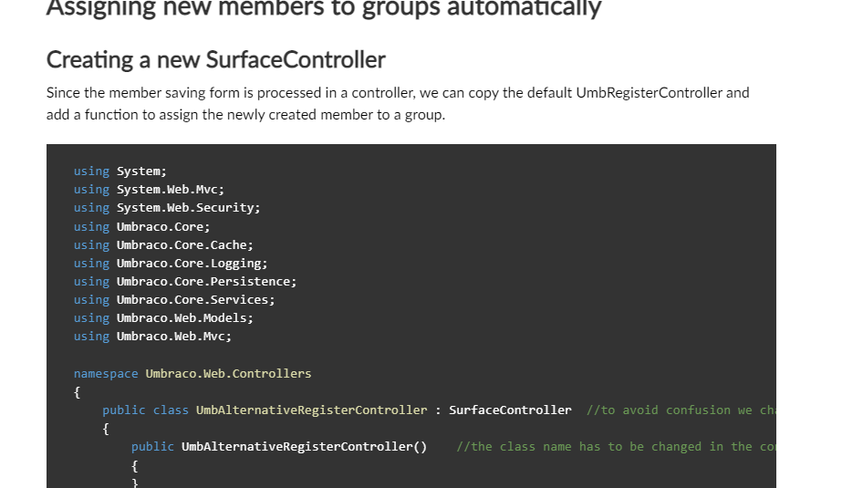

    Any tutorial member login registration for umbraco v9 ?
    Hi everyone, currently I found a tutorial in umbraco that is for v8. I trying to do a surface controller on v9. but in that tutorial is for v8. So maybe some of the api changed or some step are missing. So anyone can provide me the solution or any latest tutorial for surface controller tutorial ? Much appreciated and thanks :)
