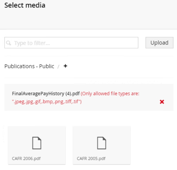

  • Harsha Balagere 1 post 71 karma points
    Aug 01, 2016 @ 18:14
    Harsha Balagere
    I just upgraded from 7.4.1 to 7.4.3 and I still the same error message when I pick a pdf file to upload. Please attached screenshot. What am I doing wrong?
