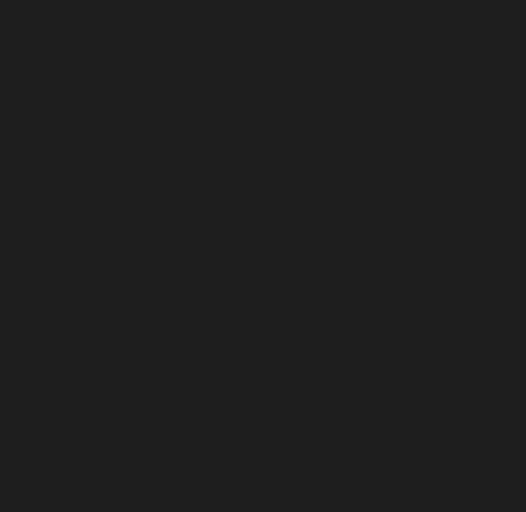

We traced the issue back to a RenderMvcController named ProductController.cs and have attached a screenshot of the specific error as shown inside of VS. To summarize, it appears Umbraco is somehow undefined and it fails wherever we use Umbraco.Media(). This is the only controller we use this in.
Below is the offending line of code and the error. Nothing in this code has changed at all (along with every other model, view, and controller). We are using uCommerce for eCommerce purposes but I am not suspecting this as the cause at this point. Also, I have tried replacing Umbraco.Media() with MediaService calls and MS also throws the Null exception.
Can you try putting Umbraco on its own line just to be sure the problem is actually with that and not with the media? For example:
var helper = Umbraco;
var media = helper.Media(swatchImage);
var url = media.Url;
Sometimes the debugger can lead you astray, so splitting it into multiple lines should help confirm that the problem is actually with the Umbraco helper.
I have resolved the issue by changing all methods to static and moving them into a new ShopController.cs non-RenderMvcController class and then fetching the media URL as follows:
var uMedia = new UmbracoHelper(UmbracoContext.Current).TypedMedia(id);
var url = uMedia.Url;

Can you try putting
Umbracoon its own line just to be sure the problem is actually with that and not with the media? For example:Sometimes the debugger can lead you astray, so splitting it into multiple lines should help confirm that the problem is actually with the Umbraco helper.
Thanks for the reply.
This seems to return the same error as well. I did notice that in the Locals panel that this error is shown for several other items.
Screenshot:
