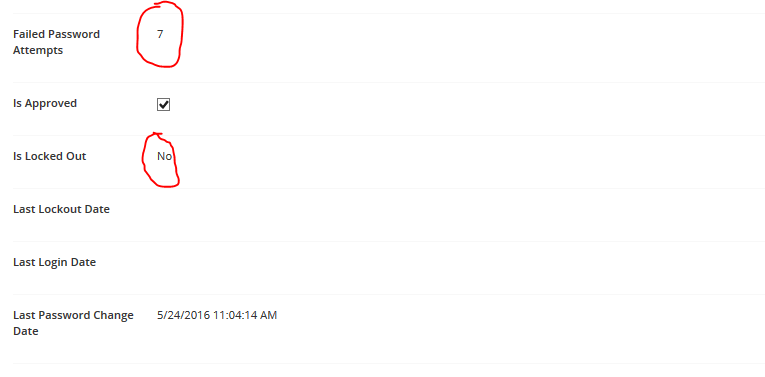

    103
    Did you try the answer in the last post? Apperantly the answer marked as solution did´nt work for Natasha. I tried the last one:
    <add name="UmbracoMembershipProvider" type="Umbraco.Web.Security.Providers.MembersMembershipProvider, Umbraco" minRequiredNonalphanumericCharacters="0" minRequiredPasswordLength="8" useLegacyEncoding="true" enablePasswordRetrieval="false" enablePasswordReset="true" requiresQuestionAndAnswer="false" defaultMemberTypeAlias="Member" passwordFormat="Hashed" maxInvalidPasswordAttempts="10" />
    And that workes for me, the user can try to login up to 10 times, then he/she gets locked out. See image:
    And if the member is not locked out and as soon as he/she enters the correct password, the "Faild attempts" gets set to 0.
    Also you wrote:
    it didnt update the number in the Members CMS area
    Do you mean the "Faied password attempts" number? I dont think this number sholud be changed after you edit the maxInvalidPasswordAttempts option, since the number in the Member CMS is the number of times the member already entered the wrong password.
