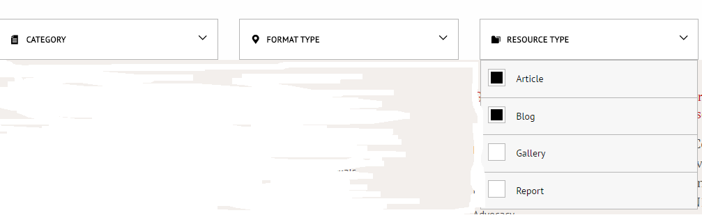

    I am using umbraco version 7.5. I added a simple search page which returns me result well if I pass a single parameter in query string. Some thing like that
    http://localhost:83/search/?search=Publication
    It is works fine but my case is little different. I have a list of check boxes and i want to refine results on basis of check box selection. enter image description here
    Here are few points on which can someone help me out
    1. How can i do this using surface controller with Ajax call.
    2. Is there any sample code with Ajax+Surface+Examine.
