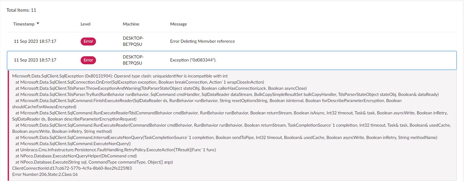

Strange side affect of having CMS import installed - can't delete a member.
Umbraco shows success, however the member is still there with 2 exceptions logged:
Removing the package fixed the member delete problem and it works as expected.

Upload image
Microsoft.Data.SqlClient.SqlException (0x80131904): Operand type clash: uniqueidentifier is incompatible with int

Hi Same issue as your other issue. Did you upgrade from a previous version?
Hi, Umbraco is an upgrade, but CMS Import is a fresh install.
It looks like it is using an old CMSImportRelation table structuire was it installed in the previous site as well? Uninstall will not remove the old tables
Hi Richard,
Seems that it was an old database schema issue.
