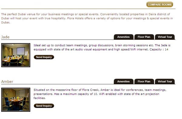

Hello,
I have a module that list all the meeting rooms and each room should have a description, list of amenities and floor plan.
The display should look like this.
The user can also compare each room. Do I need to setup each room as content page under the meetings page?
Clicking the tabs will also display a ligthbox containing the information.
I'm having a difficulty on how to do this in umbraco. Any suggestion?

Hello Sherry,
Start by creating a document type for your meeting room and make sure you have all your properties (mediapicker, descriptio,title,....)
Than you create an xslt and add your properties.
This is all very well documented on the umbraco website.
for the lightbox you can just use JQuery
Does it mean one document type for each meeting room? I already have the document type for the meetings and events but the content for this meetings and events should look like the image I posted above. I'm still a little confuse. :(

You make a document type for a type of content, not for each instance of a page of that type. You make a template for each document type, and a page for each instance, using that document type and template (they'll be associated automatically), you then create content rollups using xslt macro's that show a list of all "rooms" below the current hotel page. In this xslt you include all the functionality to show lightboxes (do you expect a lightbox when you click on a tab?)
For the compare function, this'll be a lot of fun, I suggest you focus on the lists of rooms first :p

Hi Sherry,
Create a Doc type called "Meeting Room" or something similar. On your "Meetings & events" doc type, tick the "Meeting Room" box as a child node.
Then in your content under "Meetings & events", create your 2 sub pages (Jade & Amber meeting rooms).
Insert a XSLT macro on the "Meeting & Events" template. The XSLT will list all the fields you want to show from the "Meeting Room" template.
I would probably make a tab on the "Meeting Room" doc type, for each frontend tab (Floor plan, virtual tour and so on). It's not necessary to get it working, it's just to make it easier for your editors.
The XSLT macro spits out normal HTML, so you just add the tabs and the lightbox effects with jquery.
