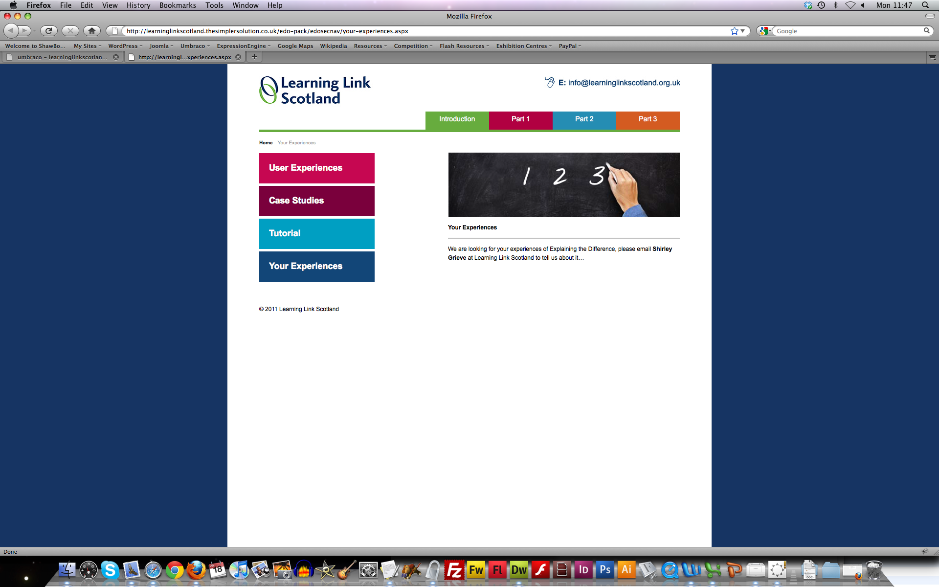

That's me managed to get the CultivForm installed and working - easy! One question though - how do I get the form to appear within one of my templates, at the moment it just appears as the form in a browser window by itself.
Darren
Darren sorry i didnt really understand what you said before......if am right you are using one template so only one layout??
What you can do is use contentPlaceholder to achieve this by using only one main Layout but with different content.
Under your main Template just create another one by selecting the main one > right click > Create. Then in your main template > Insert content area placeholder (give it a name) > then just go in the child template you created before Insert Content area (you will get the name of your created placeholder) > then just insert the Macro as in the Cultiv Razor Contact Form documentation.
Hope it makes sense :)
// Fuji
Hi Fuji,
I'm using two templates - a homepage and textpage. Basically I want to display the form in the textpage template - see attached. I'm using the older version of Cultiv Form which, I might be wrong, doesn't have an instruction manual.
Darren
I havent used the Older Version of Cultiv Form but it should be working under the same process i mentioned earlier. So bascially try to follow the steps by using the textpage template.

I think I'm getting somewhere! I've installed the package without any issue, followed Fuji's instruction above, however when the page is live I only get the intro text - no fields or title - I must be missing something on my template. Any ideas? When the CultivForm default template is selected it works.
Thanks Darren
Jan/Fuji,
Managed to get this working - it was inexperience that was causing the problem. I'm getting the hang of it now. Thanks for your help today.
