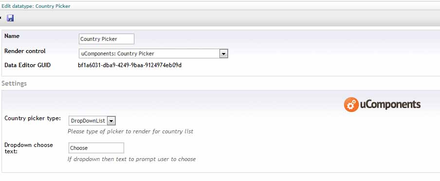

The uComponents Country Picker populates the list from .NET's System.Globalization namespace/methods. I'd feel it to be overkill trying to get the values from the Country Picker data-type. Instead, use the same code as we do.
If you're OK with the fact that the uComponents Country Picker is missing some countries (I think you said you were), you could use the same method to populate your dropdown. Check out the source code for the CountryPicker - check the FillWithIsoCountries method - you can just copy that into your usercontrol. See this blog for more info on how it works.

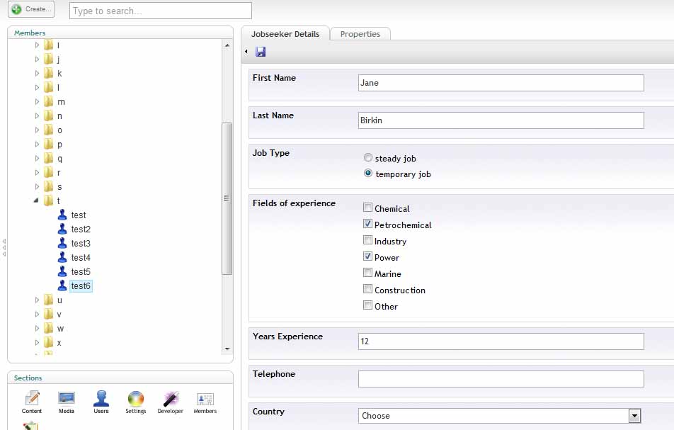

I'm back already. The problem I'm facing now is to write back a selected country from my countrie dropdownlist in the registration form to the member profile:
But this isn't working, after submitting the registration form, the selected country is not saved to my member_country property of the jobseeker member type (this property is of datatype uComponents Country Picker:
So my question is, how can I save a selected country in the registration form to my membertype?

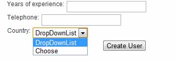

However this is the result in my registration page:
Not exactly the result I was looking for :)

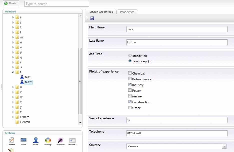

Hi Tom,
Yes, the selected country is saved now to the created member:
But I'll do some more testing on this because on my first test, I chose "Panama", and the country that was saved to the created member was "Belgium"!

yup, it's working now. I created a test user and selected Panama and the country is saved correctly to the created member:
And yes, I'm from Belgium.
