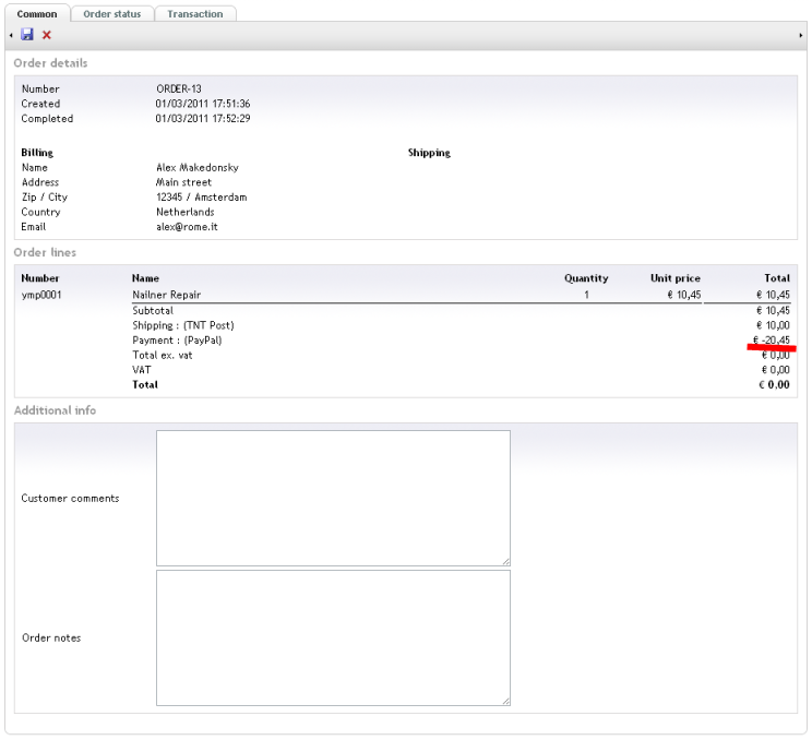

But I found another
thing - when you did payment in one currency (for example, USD), and
merchant accept another currency only (EUR), so after PayPal converts
buyer currency to seller currency, you will get the following order in
TeaCommerce:
So, as you can see, you as a seller got nothing according to the order. :) But in PayPal all OK...
I've just checked how it works with the same currencies (EUR) - unfortunately, I got the same result: negative balance in the order. :(
If you need more details to separate the issue, please tell me and I will try to provide those data for you. I'd like to help make that product better. :)

But I found another thing - when you did payment in one currency (for example, USD), and merchant accept another currency only (EUR), so after PayPal converts buyer currency to seller currency, you will get the following order in TeaCommerce:

Did you install the latest version of Tea Commerce? As we have had a similar error like that?
If you make a payment in the merchant accepted currency it all works fine? Only when paypal convert?

Yes, I have latest TeaCommerce - 1.1.1.0...
Could you try and change paymentaction back to authorization. Just to check if its only a problem when doing auto capture. Thanks for your help solving the issue
Hi Anders,
With "authorization" as option pf paymentaction and manual capturing the funds order looks as expected - no negative balance. So it might be a problem with auto capture.
Okay - i will look into it
I have now tested this issue and a fix will be out in the next release.
