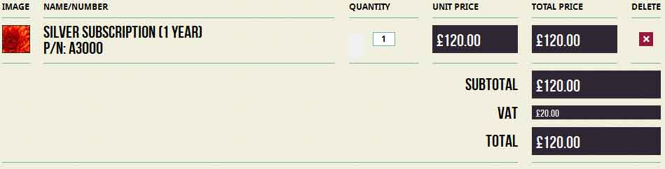

I'm always getting confused by VAT *sigh* so correct me if I'm wrong here.
Using the starter kit, the price for the product is £100 for all the examples.
The 'Prices in DB incl. VAT' setting is NOT ticked the VAT group for the order has been set to 20%.
You can see it has added the VAT which is good.
The 'Prices in DB incl. VAT' setting is NOT ticked the VAT group for the order has been set to 0%.
No VAT has been added as you would expect.
It's when you tick the 'Prices in DB incl. VAT' setting that I'd expect things to work a little different.
The 'Prices in DB incl. VAT' setting is ticked the VAT group for the order has been set to 20%.
The VAT element is worked out and displayed as you would expect.
The 'Prices in DB incl. VAT' setting is ticked the VAT group for the order has been set to 0%.
Zero VAT is displayed as you would expect, but I would also expect the total price to have been re-reduced to remove the VAT amount?
