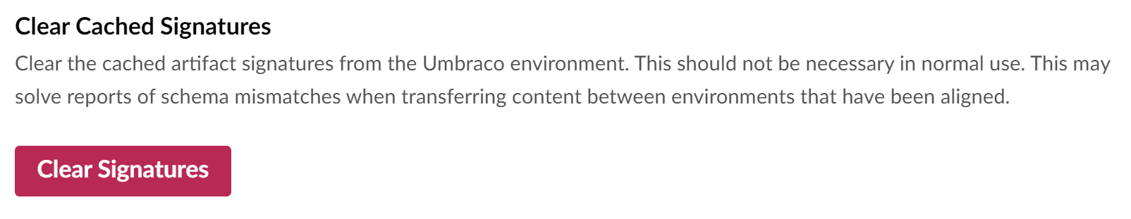

Umbraco Deploy maintains a cached set of signatures that represent each schema and content item. They are used when transferring or restoring content between environments to aid performance.
If having resolved schema mismatches you still have reports of errors, it might be that the signatures are out of date. In other words, Deploy is using a cached representation of an item that no longer matches the actual item stored in Umbraco.
This should not be necessary in normal use, but can occur after upgrades. If you have this situation, you can clear the cached signatures in both the upstream and downstream environments. You do this via the Clear Cached Signatures operation available on the Settings > Deploy dashboard:

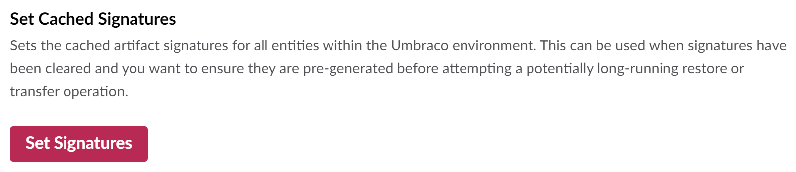

Ensure signatures are pre-cached
For transfer or restore operations, it's worth ensuring Deploy's cached signatures are fully populated in both the upstream and downstream environments. This can be done via the Set Cached Signatures operation available on the Settings > Deploy dashboard:
The process make take a few minutes to complete if you have a lot of content or media in your installation. Information is written to the log indicating the signatures calculated for each entity type.
Now the checks Deploy has to do to figure out the items and dependencies to process will complete much more quickly.

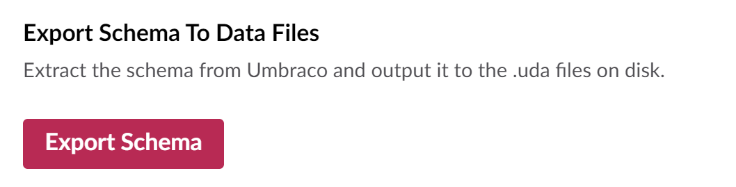

Schema files following upgrades
When Umbraco schema items are created, a representation of them is saved to disk as a .uda file in the /data/revision/ folder. The representation is known as an artifact. It will be refreshed on further updates to represent the current state of the schema item.
Following an upgrade, it's possible the contents of the file will no longer match what would be generated by the current version. For example, if a property has been added to an artifact, this will be absent in the file. It would be added if the file was recreated following the upgrade.
This can lead to situations where Deploy continues to process a file it considers changed, even though the item represented is up-to-date. This in turn means slow updates of Umbraco schema, as Deploy is processing more files than it needs to do.
To resolve this situation, following an upgrade it is good practice to resave the .uda files in the "left-most" environment. This will usually be the local one, or if not using that, the Development environment. You can do this via the Export Schema To Data Files operation available on the Settings > Deploy dashboard:
The updated files should be committed to source control and deployed to upstreamm environments.
