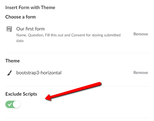

Whether you are inserting your form using a macro or adding it directly in your template, you need to make sure ExcludeScripts is checked/enabled.
When inserting forms using the Insert Form with Theme macro:
