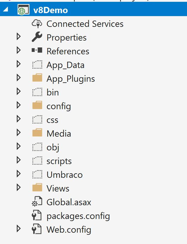

The Umbraco Folder
The main folder where the Umbraco CMS resides in, is the /umbraco one inside your project.
The contents change when you upgrade Umbraco, but no part of your implementation or third party packages installed should update this folder. Historically that has not always been the case, and in the past icons and plugins have been added within this folder.
If you are using NuGet to manage this package inside your solution, this should not need to be source controlled. If you are working with Visual Studio and a Build Server, it's NuGet's job to restore the correct versions of this folder for you. You shouldn't include this folder in your Visual Studio project, as there is a build step, that ensures it is 'deployed' along with your solution when using Web Deploy.

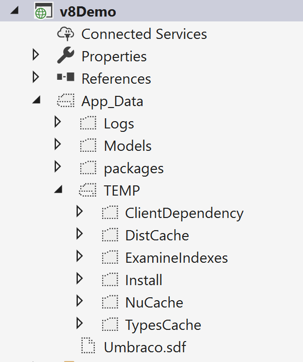

App_Data Folders
When Umbraco is running it will generate and update some files on disk:
- For image caching purposes,
- Logging,
- Site search indexes,
- And the published cache file amongst others.
Unless configured otherwise, these will be created in the /App_Data folder of your application, and do not need to be source controlled.
They include:
cache- ImageProcessor ships with Umbraco and when an image is requested via the processor, eg to be resized or cropped, a cached version of the transformed image will be stored in this folder. (The ImageProcessor Config/config/imageprocessor/cache.configallows you to determine where this cache is stored)Logs- Umbraco currently uses Serilog, and a file will be generated in this folder containing tracelogs of your application, one JSON file for each day.NuGetBackup- If you've installed or upgraded Umbraco via NuGet, then a backup of files before they were replaced will be copied here.Temp- as the name suggests, temporary no need to source control.ClientDependency, Umbraco uses the Client Dependency Framework, to minimise and combine css/js resources into single requests for use in the Umbraco backoffice - a cache of the processed resources are maintained in this folder.ExamineIndexes, Umbraco uses Examine (a provider based Indexer/Searcher API that wraps the Lucene.Net indexing/searching engine) to index content and members for the Umbraco backoffice search, unless configured otherwise the indexes will be generated in this folder.PluginCache- a hash and list of the plugins installed in your implementation, for detection of changes at startup.
Umbraco.sdf- If you are using SQLCE for the data store in your Umbraco site, then this file IS that datastore, it will be difficult to source control the constant changes to this file.
There is a file /App_Data/packages/installedPackages.config that lists all packages installed via the Umbraco backoffice, depending on how you update or install packages to your site, it can be useful to track changes to this file in source control.

Media
The Media section of Umbraco (unless configured otherwise) stores files in the /Media folder, these can be updated by editors, in the Umbraco backoffice, so generally speaking you would not source control these files.
Packages and Plugins
The App_Plugins folder is the home for all third party packages installed on your site.
Depending on how you installed the plugin it will affect how you choose to version control a particular third party plugin:
- NuGet - if the plugin is installed via NuGet then as long as the packages.config file in the root of your project is source controlled, then the installed files for individual plugins shouldn't need to be source controlled (and your deployment process should pull the packages implementation files from NuGet during the build and deployment process).
- Backoffice - if your working with other developers, then it may be easier to add the plugin files to source control, or at least communicate to them that the particular package needs be installed via the backoffice.
- Backoffice + Buildserver - you'll need to include the plugin files in source control as the build server won't know to restore them - if the plugin/package doesn't come with a NuGet resource, consider setting up your own local NuGet repository for your build server to pull the files from.
Each plugin could be different depending on its implementation and functionality. It may contain files that it would be useful to track via Source control, and also files that should be ignored: check with the plugin's supporting website/developer for more information.
