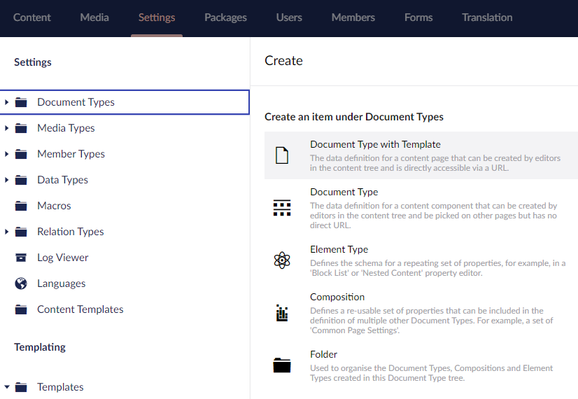

A Document Type is created using the Document Type editor in the Settings section.
Go to the Settings section in the backoffice. On the Document Types node click the menu icon (•••) to bring up the context menu. Here choose Document Type with Template. This will create a new Document Type with a template. The Template can be found under Templates in the Settings section that will be assigned as the default template for the Document Type.
You can also choose to create a Document Type without a template and create Folders to organize your Document Types.

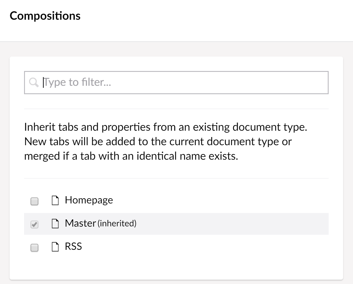

You can also use Composition to create a new Document Type. Compositions allow you to inherit properties from other groups. When using a mixed setup, you can take advantage of nesting and use compositions by visiting the Structure group. A checklist like this should appear:

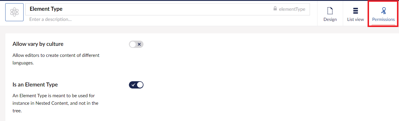

What is an Element Type?
An Element Type is a Document Type without a template containing schema configurations for repeating a set of properties. These are for defining schema in the Block List Editor, Nested Content, Block Grid Editor, or other Element Type based editors. Element Types cannot be used to create content that resides in the Content tree. When you create an Element type, it automatically sets the Is Element Type flag to True on the Permissions tab.
Element Types are created using the same workflow as regular Document Types but usually contain fewer properties. You can also create Element Types as part of configuring a Block Grid or Block List Data Type.

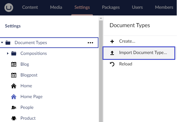

Exporting/Importing the Document Type

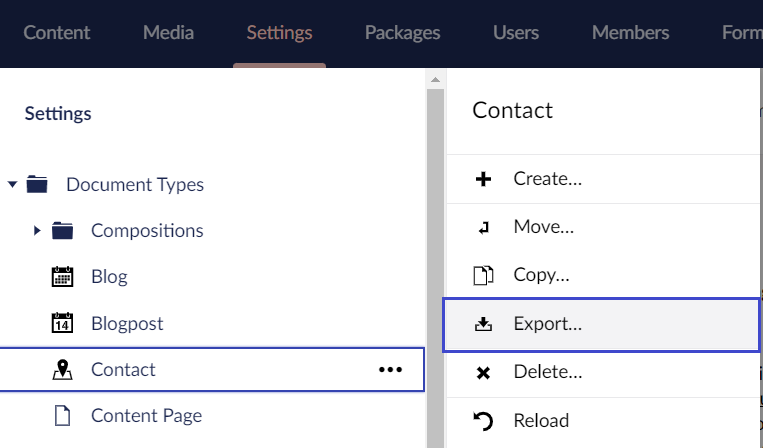

You can export document types from a project/installation and import them into another project/installation. Go to the Settings section, right-click the Document type, and select Export. When you click on the Export button, the Document Type is saved as *.udt file.
To import a Document Type, go to the Settings section, right-click the Document type, and select Import Document Type. Click on the Import button and browse to the Document Type you exported. The Name and Alias of the Document Type are displayed. Click Import to complete the process.
- If your Document Type contains compositions or inherits from another Document Type, then you need to export/import the Composition/Document Type too.
- You cannot export/import document types on Umbraco Cloud.

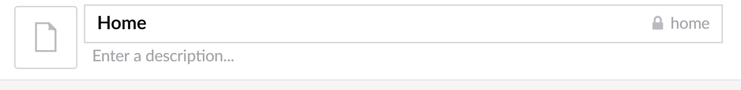

First, we're prompted to give the Document Type a name. This first Document Type will be the root node for our content, name it "Home".
Notice that the alias of the Document Type is automatically generated based on the name. If you want to change the alias click the "lock" icon.

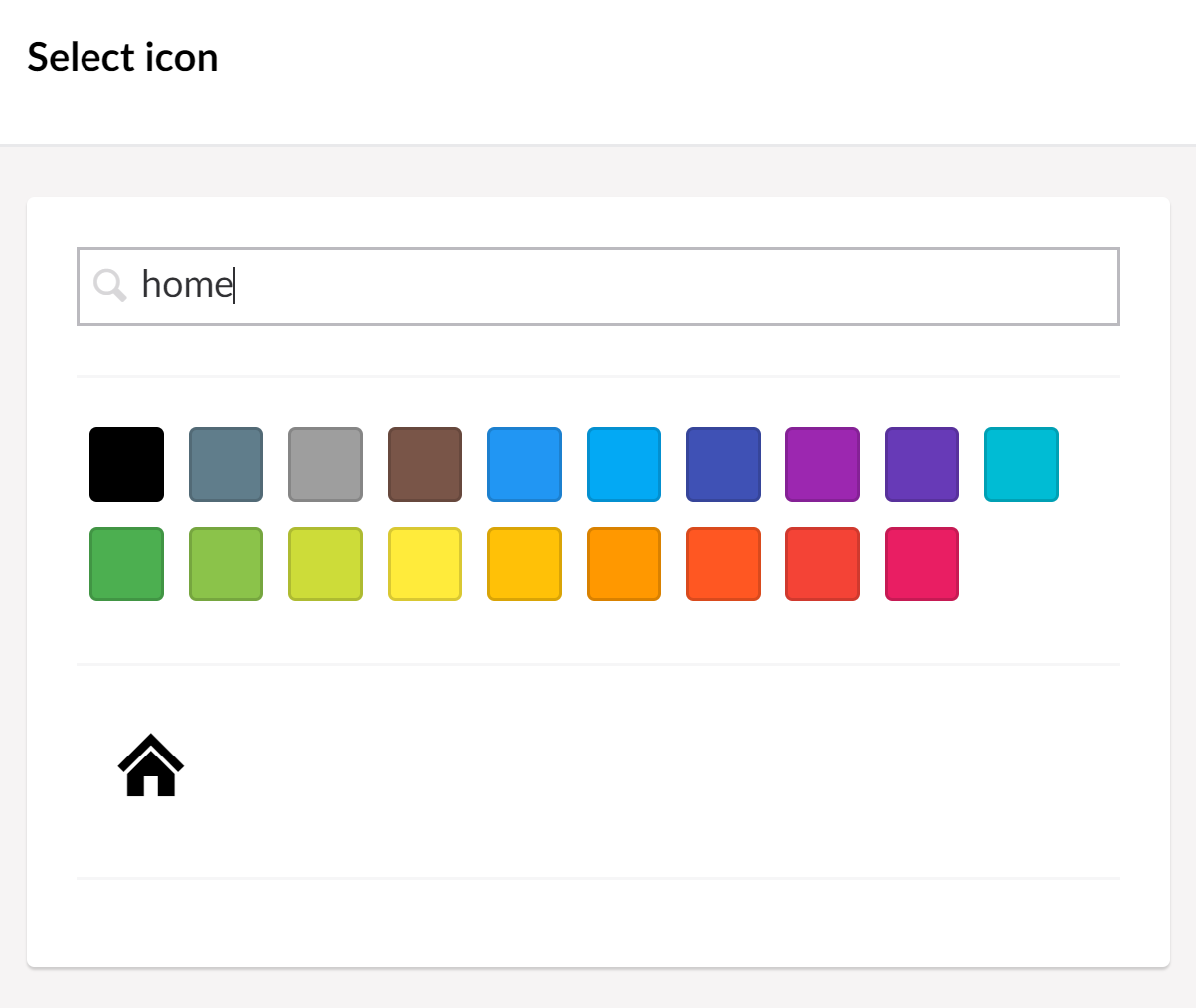

To set an icon for the Document Type click the document icon in the top left corner. This will open the icon select dialog. Search for Home and select the icon. This icon will be used in the content tree. Choosing appropriate icons for your content nodes is a good way to give editors a better overview of the content tree.

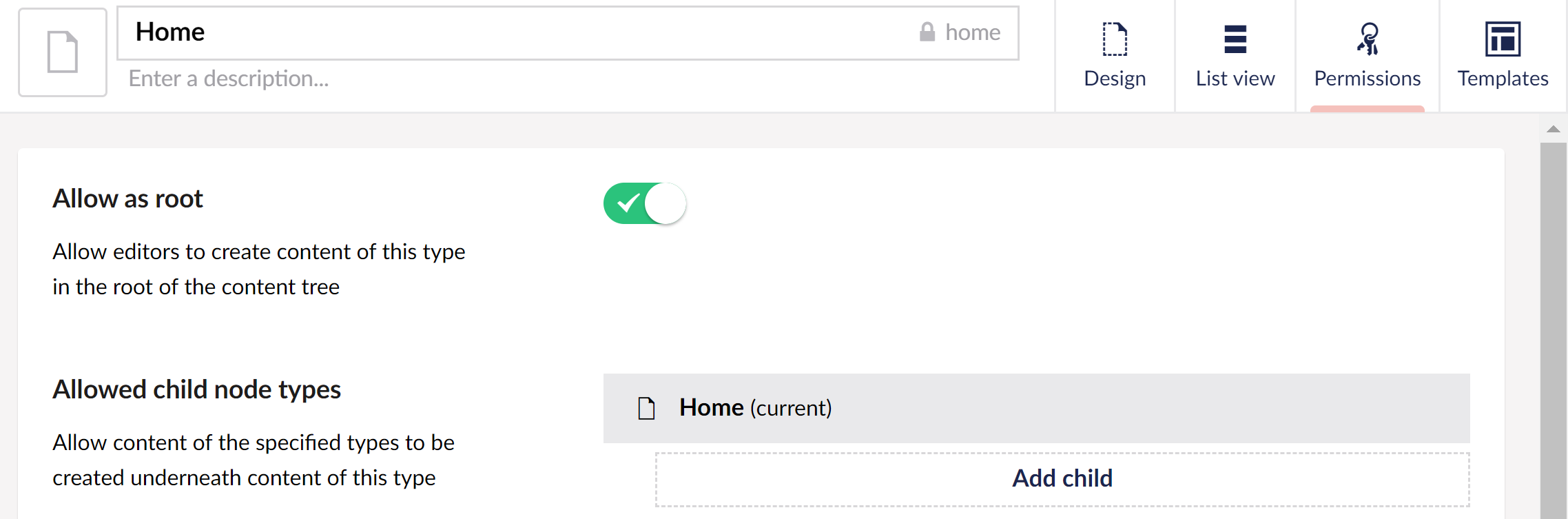

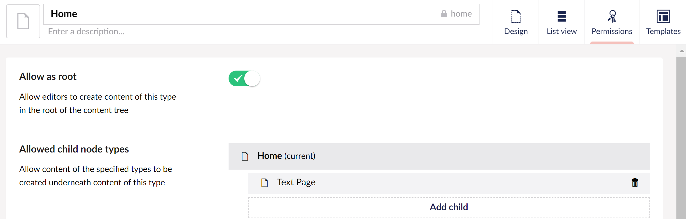

Go to the Permissions tab and tick the Allow as root toggle and save the Document Type by clicking save in the bottom right corner.

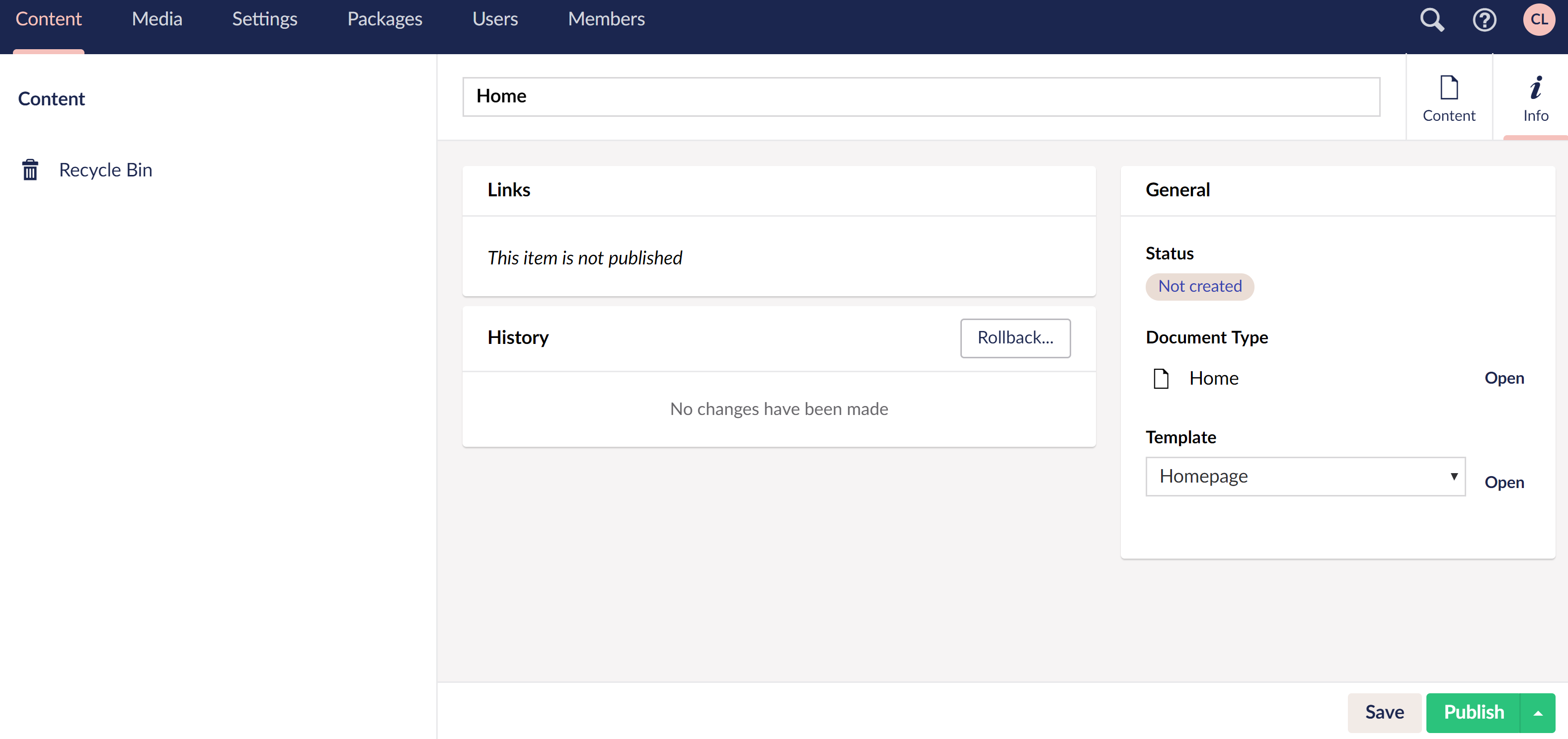

Now go to the Content section, click on the menu icon next to Content and Select the Home Document Type. We'll name it "Home" and click the Save and Publish button.
As we haven't created our properties, all we can see on the "Home" node is the Properties tab. This tab contains the default properties that are available on all content nodes in Umbraco.

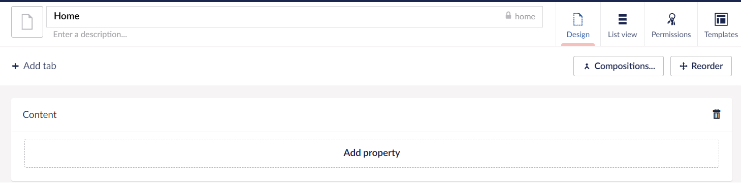

Before we start adding properties to the Document Type we need to create a group to hold the property.
Click Add group and name the group "Content".

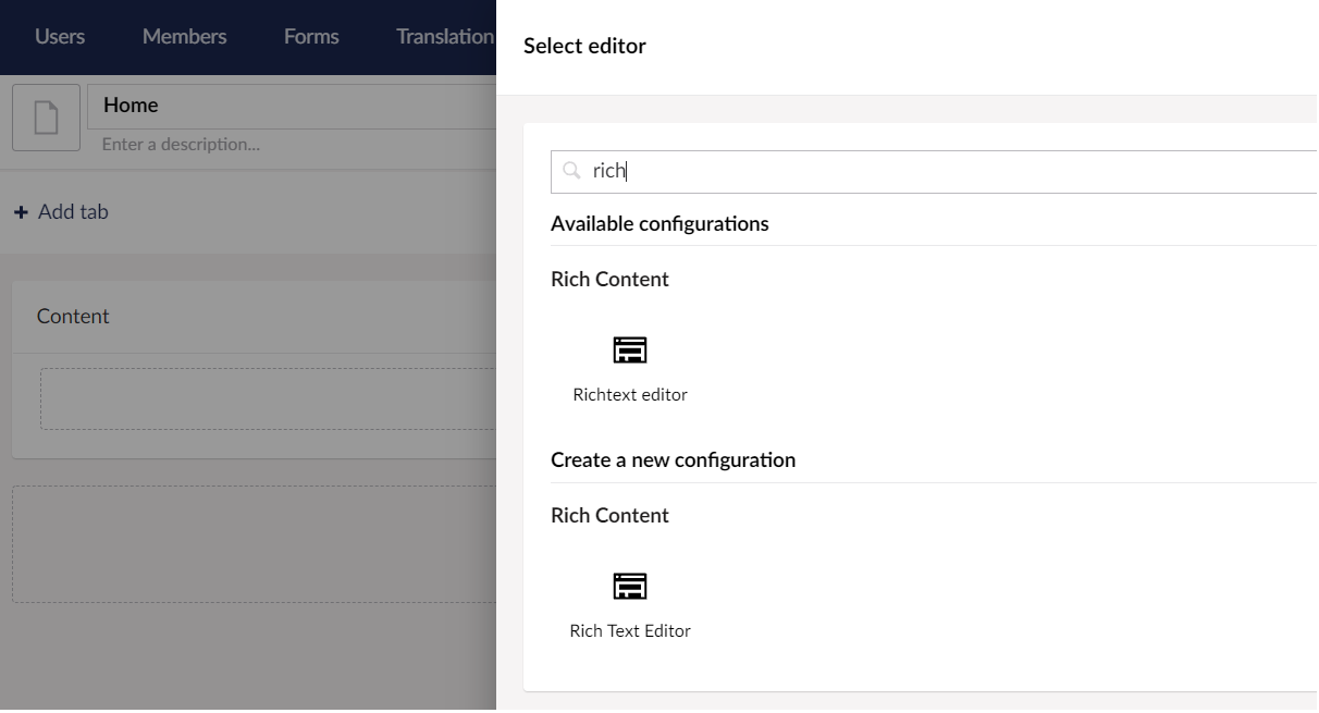

Property editors
Clicking Select editor will open the Select editor dialog. Here, you can choose between all the available editors on the Create a new configuration tab. This will create a new configuration or already configured editors in the Available configurations tab. To make it easier to find what you need use the search field to filter by typing "Rich". Filtering will display configured properties first (under Available configurations) and all available editors under that.
Select the Rich Text editor under Create new.
This will let you configure the editor settings - the Rich Text editor for this property.
The name of the Data Type is based on the name of the Document Type, the name of the property, and the property editor. Flor example: Home - Body Text - Rich Text editor.
Let's rename it to "Basic Rich Text editor" and only select the most necessary options.

Before creating a Text Page in Content section, allow the Text Page Document Type to be created as a child node to the Home node. Select the Home Document Type and go to the Permissions group. Click Add child and select Text Page.

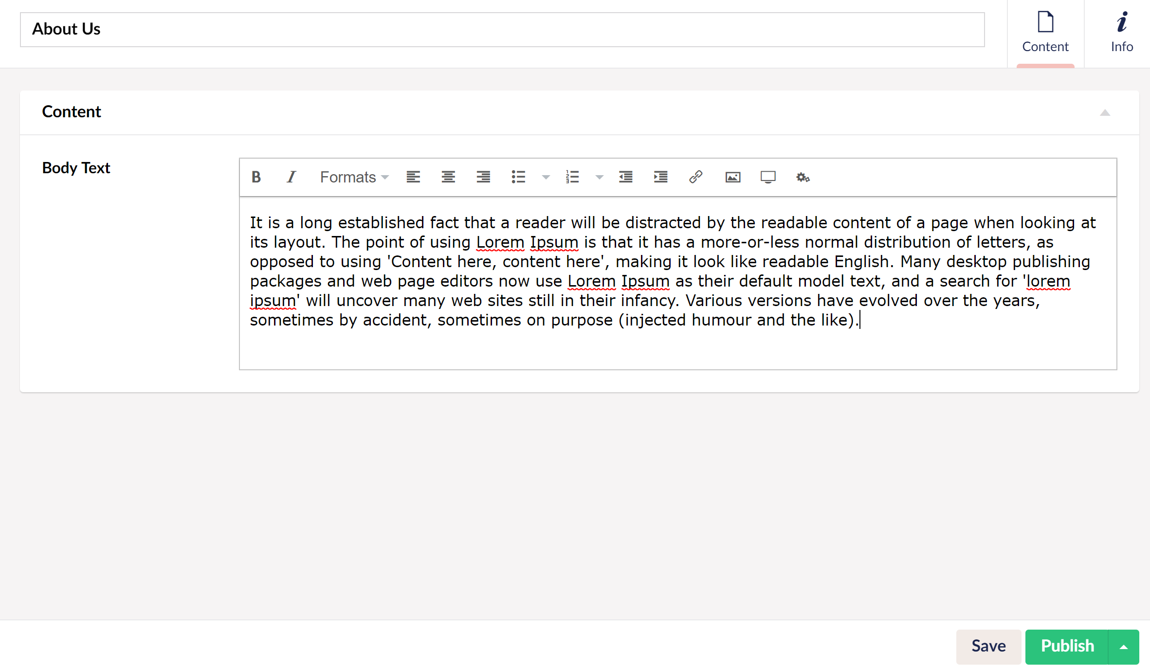

Go to the Content section and click the menu icon (•••) next to the Home node and select the Text page Document Type. We'll name the page "About us". We now have a basic content structure.
