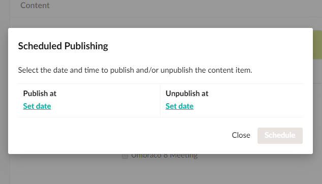

You can find the options to do this click on the arrow next to the Save and publish button and pick Schedule...
This will open a Schedule Publishing dialog where you can specify dates and time.

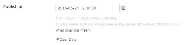

Your server may be in a different timezone than where you are located. You are able to select a date and time in your local timezone and Umbraco will make sure that the item gets published at the selected time. So, if you select 12PM then the item will be published at 12PM in the timezone you are in. This may be 8PM on the server, which is indicated when you select the date and time.
If you are in the same timezone as the server, this message will not appear under the date picker.
