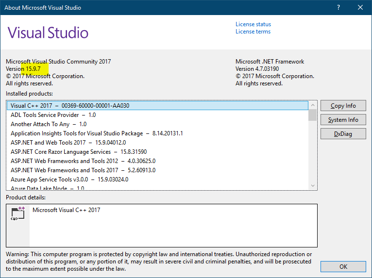

Note: Check that your Visual Studio version is at least 15.9.6 (Help > About Microsoft Visual Studio), lower versions do not install the correct NuGet dependencies.

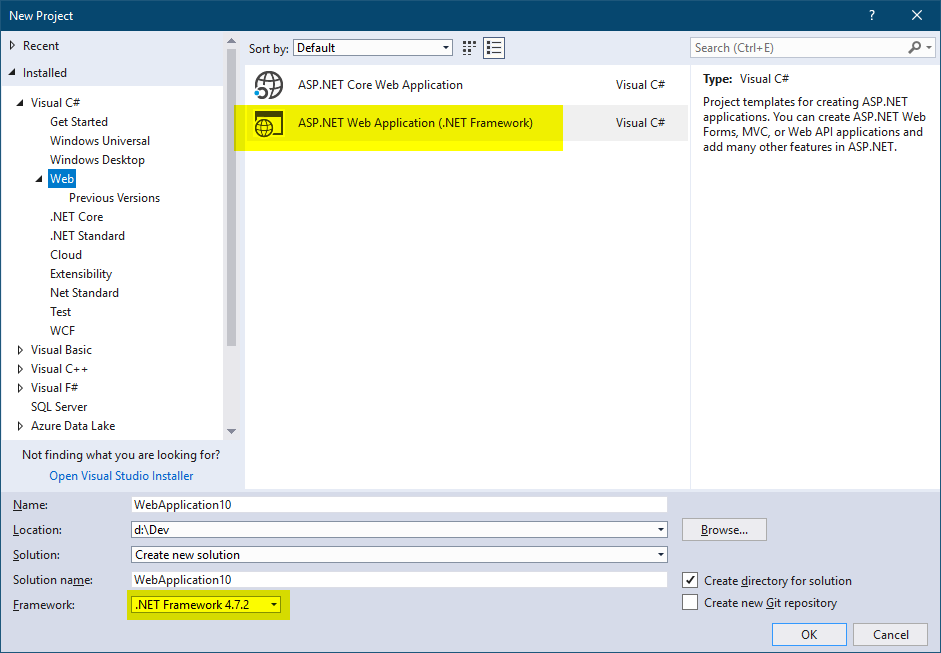

Visual Studio 2017
Go to File > New Project and pick an ASP.NET Web Application.
Note: Double check that in the "Framework" dropdown you've selected .NET Framework 4.7.2, Umbraco will not work with lower versions than 4.7.2. Similarly, refrain from naming your solution Umbraco, as this will cause a namespace conflict with the CMS itself.

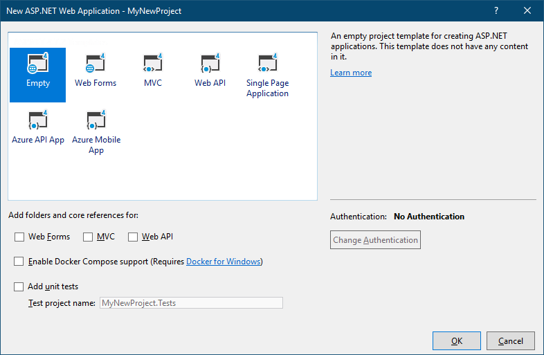

On the next step, select the Empty template. It's important to pick empty as other templates include incompatible versions of MVC and Json.NET. (Don't enable any of the checkboxes to add folders or core references. Umbraco will add them for you).

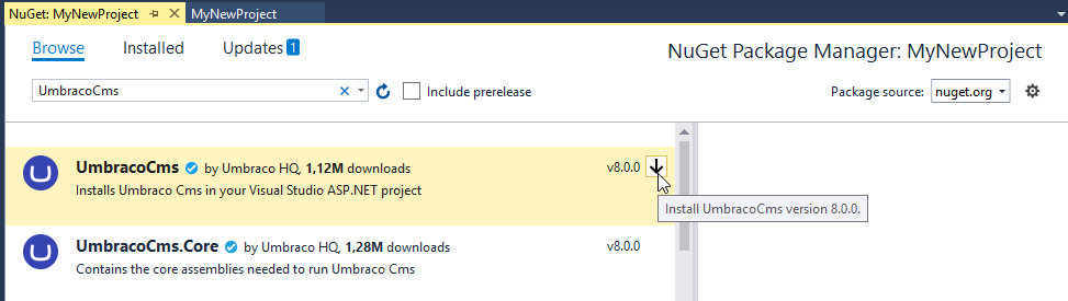

The latest release of Umbraco is always available in the NuGet gallery. All you have to do is search for it and install.

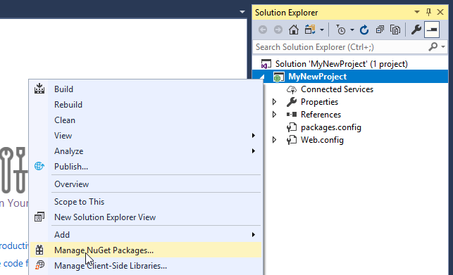

To install Umbraco from the Visual Studio interface, right-click on the new project you've made and choose Manage NuGet Packages.
You can then use the search function to find the package called UmbracoCMS. You'll also find the Umbraco CMS Core Binaries package and the Umbraco CMS Web package, they will be included automatically when you choose Umbraco CMS. So make sure to pick Umbraco CMS (highlighted in the image below) and click the Install icon (arrow down).
NuGet will then download dependencies and will install all of Umbraco's files in your new solution.

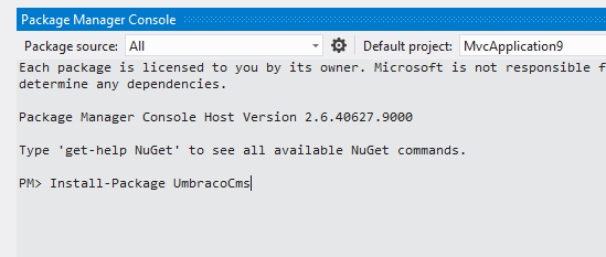

Package manager console
You can do the exact same thing from the package manager console, which is a bit quicker as you don't have to click through the menus and search.

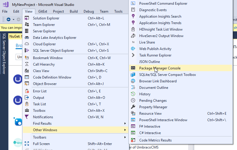

Enable the console by going to Tools > View > Other Windows > Package Manager Console.
Then type Install-Package UmbracoCms to start installing the latest version of Umbraco.
