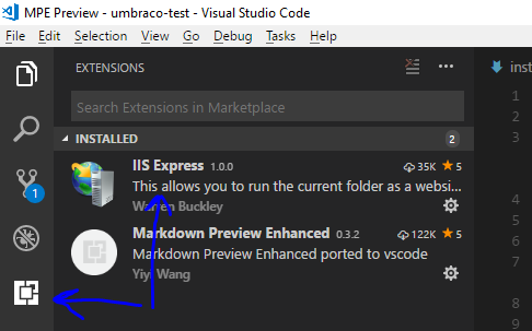

Click the extensions menu at the bottom on the left side. Then search for IIS Express, install it then press reload.

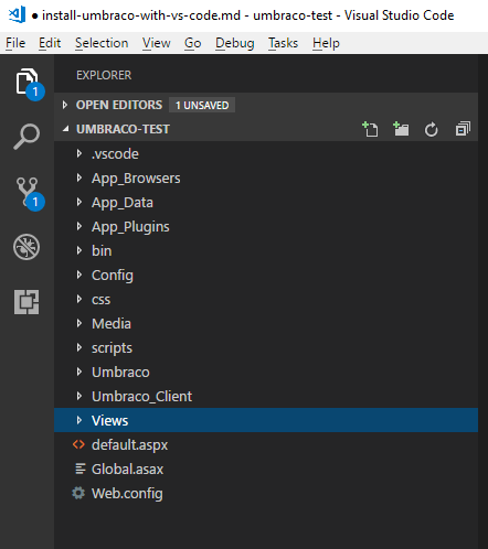

Download a fresh Umbraco installation from https://our.umbraco.com/download/ then unzip and drag it into VS Code.

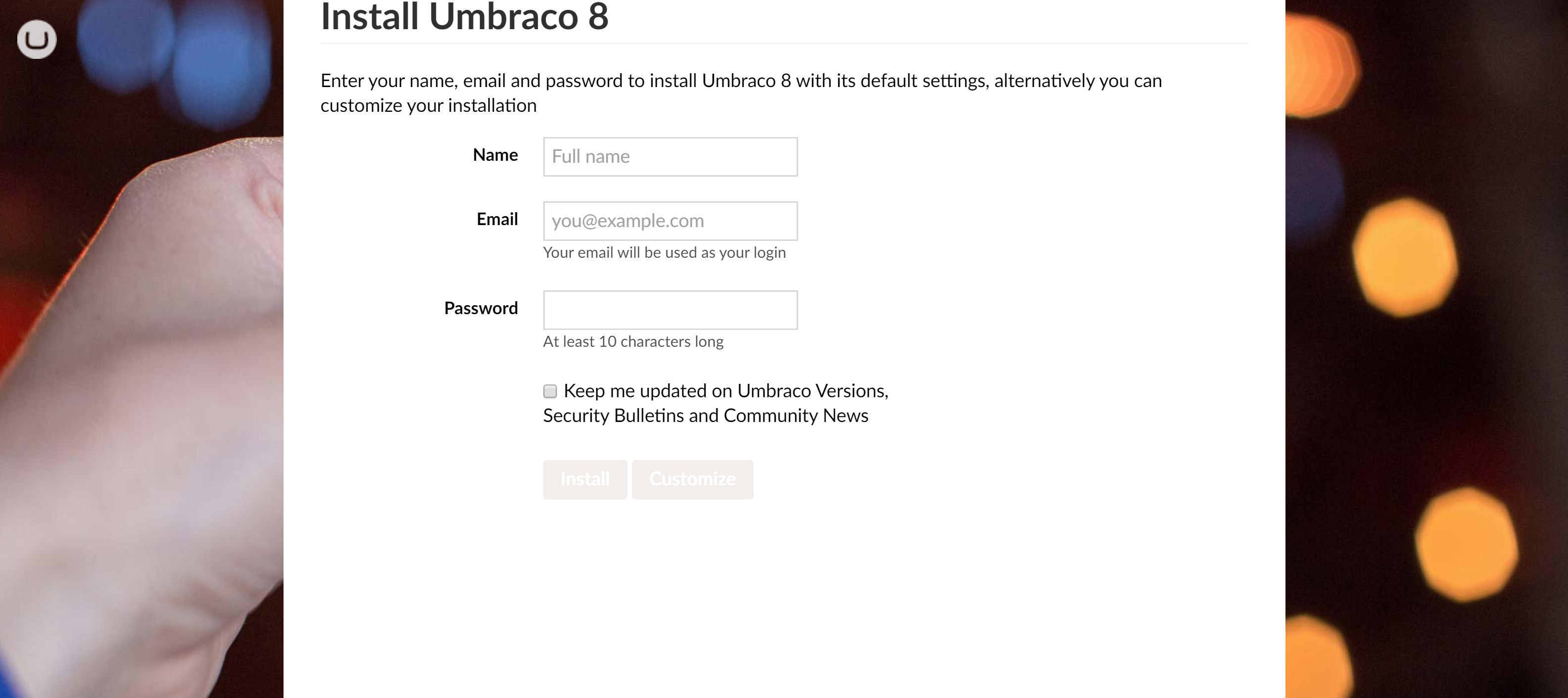

You will see the welcome screen. If you want a fast demo site fill in the information and click Install! If you want to decide the database type, or install without a starter site then click Customize!

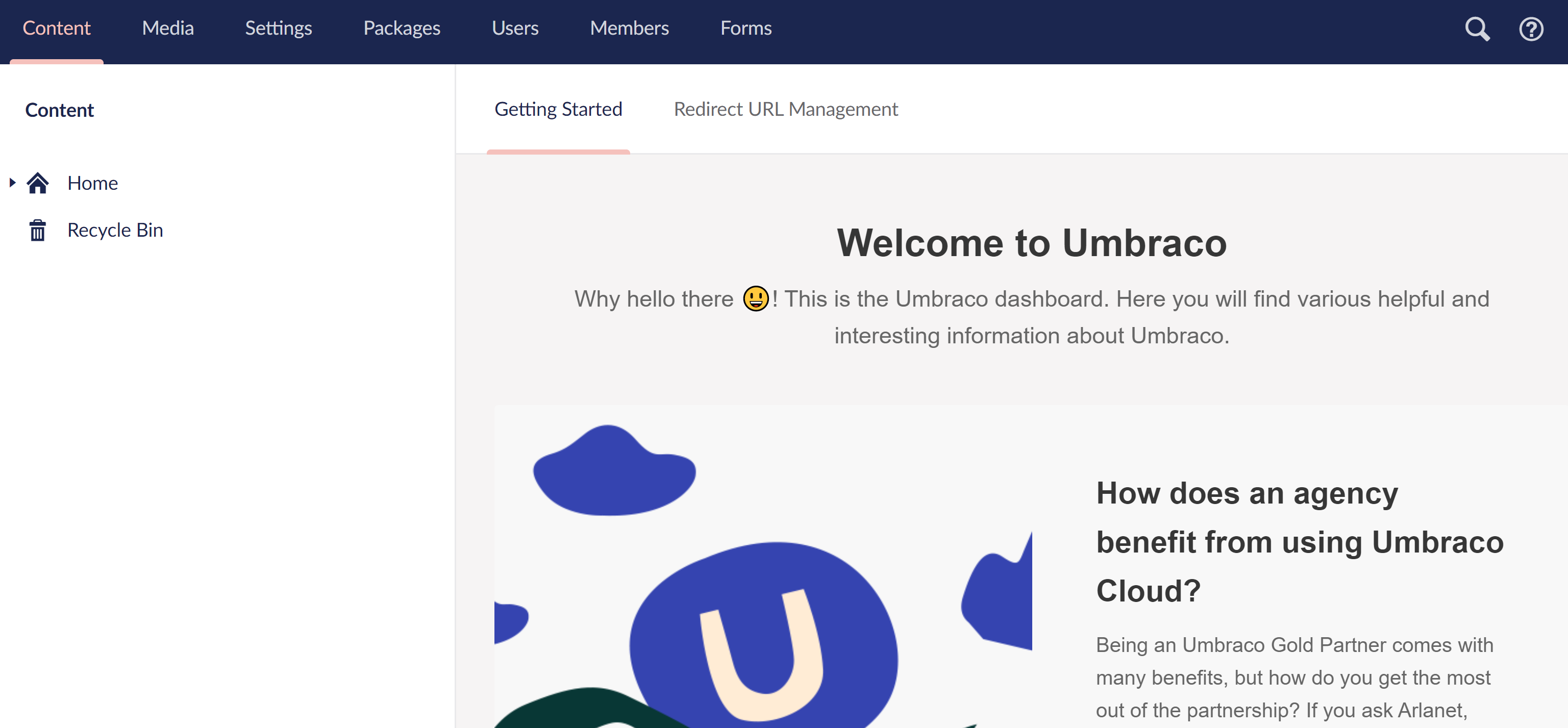

When the installer is done you will automatically be logged into the backoffice.
Celebrate - you're all done!
Congratulations, you have installed an Umbraco site!
