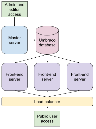

The following diagram shows the data flow/communication between each item in the environment:
The process is as follows:
- Administrators and editors create, update, delete data/content on the master server
- These events are converted into data structures called "instructions" and are stored in the database in a queue
- Each front-end server checks to see if there are any outstanding instructions it hasn't processed yet
- When a front-end server detects that there are pending instructions, it downloads them and processes them and in turn updates it's cache, cache files and indexes on its own file system
- There can be a delay between content updates and a front-end server's refreshing, this is expected and normal behaviour.

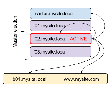

Umbraco will automatically elect a "Scheduling server" to perform the above services. This means that all of the servers will need to be able to resolve the URL of either: itself, the Master server, the internal load balancer or the public address.
For example, In the following diagram the replica node f02.mysite.local is the elected "Scheduling server". In order for scheduling to work it needs to be able to send requests to itself, the Master server, the internal load balancer or the public address. The address used by the "Scheduling server" is called the "umbracoApplicationUrl".
By default, Umbraco will set the "umbracoApplicationUrl" to the address made by the first accepted request when the AppDomain starts. It is assumed that this address will be a DNS address that the server can resolve.
For example, if a public request reached the load balancer on www.mysite.com, the load balancer may send the request on to the servers with the original address: www.mysite.com. By default the "umbracoApplicationUrl" will be www.mysite.com. However, load balancers may route the request internally under a different DNS name such as "f02.mysite.local" which
by default would mean the "umbracoApplicationUrl" is "f02.mysite.local". In any case the elected "Scheduling server" must be able to resolve this address.
In many scenarios this is fine, but in case this is not adequate there's a few of options you can use:
- Recommended: set your front-end(s) (non-admin server) to be explicit replica servers by creating a custom
IServerRegistrar, this means the front end servers will never be used as the master scheduler - Set the
umbracoApplicationUrlproperty in the Web.Routing section of /Config/umbracoSettings.config
