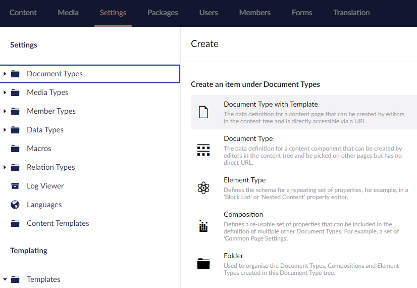

    Creating a Document Type
    A Document Type is created using the Document Type editor in the Settings section.
    Go to the Settings section in the backoffice. On the Document Types node click the menu icon (•••) to bring up the context menu. Here choose Document Type with Template. This will create a new Document Type with a template. The Template can be found under Templates in the Settings section that will be assigned as the default template for the Document Type.
    You can also choose to create a Document Type without a template and create Folders to organize your Document Types.

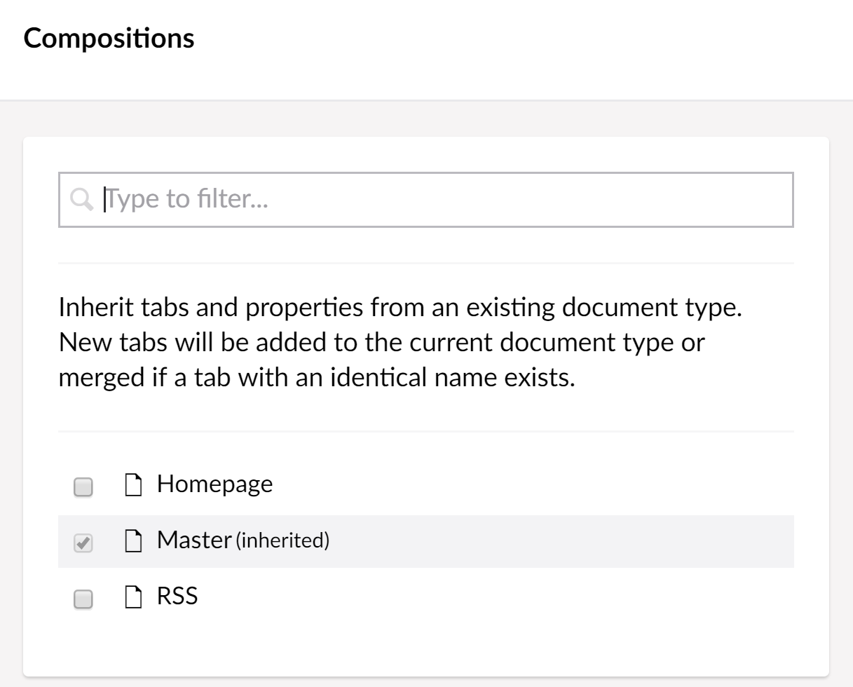

    You can also use Composition to create a new Document Type. Compositions allow you to inherit properties from other groups. When using a mixed setup, you can take advantage of nesting and use compositions by visiting the Structure group. A checklist like this should appear:
    Creating a Compositions

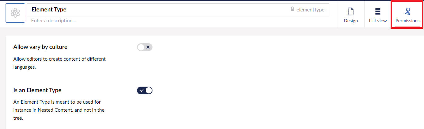

    Finally, you can create a Document Type as an Element Type which can be used to build Block Grid and Block List editors. Learn more about Element Types below.
    What is an Element Type?
    An Element Type is a Document Type without a template containing schema configurations for repeating a set of properties. These are for defining schema in the Block List Editor, Nested Content, Block Grid Editor, or other Element Type based editors. Element Types cannot be used to create content that resides in the Content tree. When you create an Element type, it automatically sets the Is Element Type flag to True on the Permissions tab.
    Element Type
    Element Types are created using the same workflow as regular Document Types but usually contain fewer properties. You can also create Element Types as part of configuring a Block Grid or Block List Data Type.

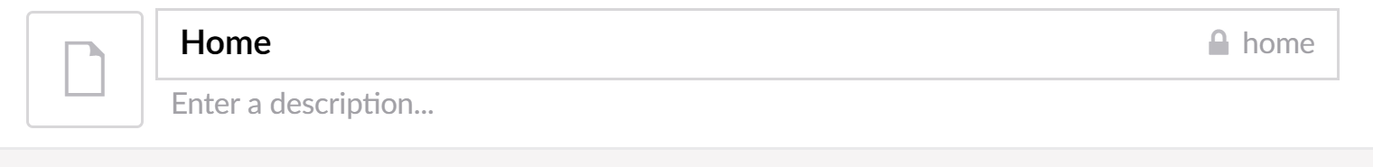

    First, we're prompted to give the Document Type a name. This first Document Type will be the root node for our content, name it "Home".
    Naming a Document Type
    Notice that the alias of the Document Type is automatically generated based on the name. If you want to change the alias click the "lock" icon.

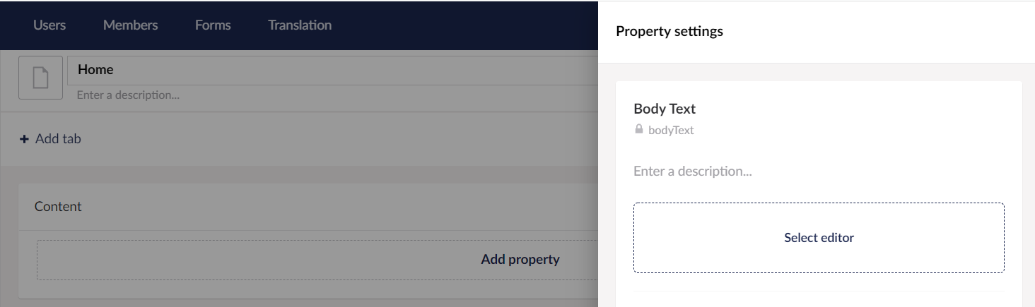

    Now that we have created a group we can start adding properties. Let's add a Rich Text editor to the Content group.
    Click the Add property link in the Content group. This opens the property settings dialog. Here you can set the metadata for each property (name, alias, description), choose which Data Type/property editor to use, and add validation if needed.
    Give the property a name, the name will be shown to the editor to make it relevant and understandable. Notice the alias is automatically generated based on the name. We'll name this "Body Text".
    Adding a property

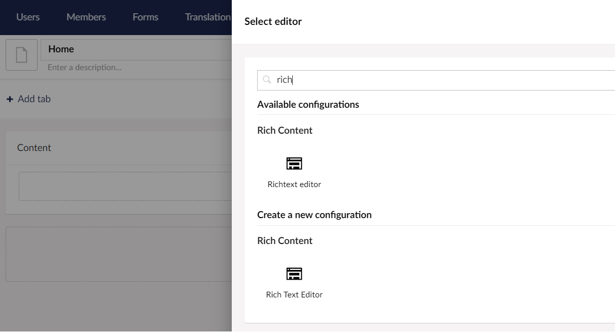

    Property editors
    Clicking Select editor will open the Select editor dialog. Here, you can choose between all the available editors on the Create a new configuration tab. This will create a new configuration or already configured editors in the Available configurations tab. To make it easier to find what you need use the search field to filter by typing "Rich". Filtering will display configured properties first (under Available configurations) and all available editors under that.
    Select the Rich Text editor under Create new.
    Choosing the Rich Text editor
