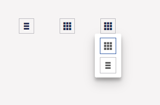

When you have a list of items, you can use the umb-layout-selector directive to let users toggle between different layouts. For instance, in Umbraco's media archive, users can select between a grid-based layout (thumbnails) and a list-based layout (table).

<div ng-controller="myController"> <umb-layout-selector layouts="layouts" active-layout="activeLayout" on-layout-select="selectLayout(layout)"> </umb-layout-selector> </div>
