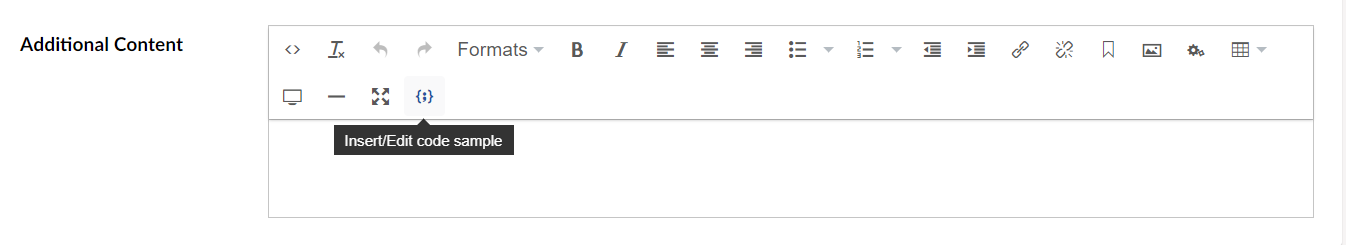

    And in our Rich Text Editor, we now have a 'Code Sample' syntax highlighting option:
    Code Sample Button in ToolBar
    Pressing the button allows the selecting of a code language and the sample code to be entered:

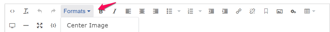

    Style Formats

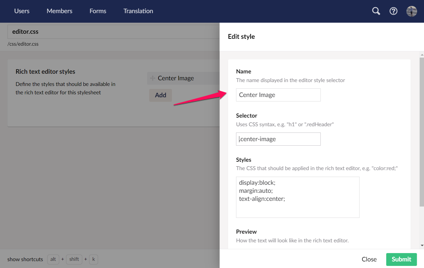

    Umbraco provides a mechanism for using a CSS stylesheet + comments, updated via a nice backoffice UI to set custom style formats for a Rich Text Editor configuration:
    Add style format rule via backoffice
    This enables editors to apply style formats to text using the 'Formats' dropdown
    Style format dropdown
