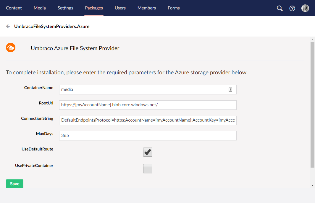

    The following six keys will have been added to the <appSettings> in your web.config file.
    <?xml version="1.0"?>
    <appSettings>
      <add key="AzureBlobFileSystem.ContainerName:media" value="media" />
      <add key="AzureBlobFileSystem.RootUrl:media" value="https://[myAccountName].blob.core.windows.net/" />
      <add key="AzureBlobFileSystem.ConnectionString:media"
        value="DefaultEndpointsProtocol=https;AccountName=[myAccountName];AccountKey=[myAccountKey]" />
      <add key="AzureBlobFileSystem.MaxDays:media" value="365" />
      <add key="AzureBlobFileSystem.UseDefaultRoute:media" value="true" />
      <add key="AzureBlobFileSystem.UsePrivateContainer:media" value="false" />
    </appSettings>
    Make sure to update this configuration to match your own setup. For example AzureBlobFileSystem.UsePrivateContainer:media needs to be set to true if your blob container is not publicly accessible - see below.
    When you're installing the package from the Package section of the Umbraco Backoffice, you can add configuration from the backoffice:
    Setup from backoffice
