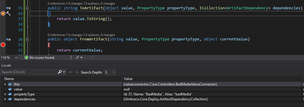

    It will hit your breakpoint, and if you continue you will then get an error. On the breakpoint you can see why the error occurs. It should look like this:
    Hitting the breakpoint
    Here you can see that value is null, and if you try to return value.ToString() you will get a null exception.

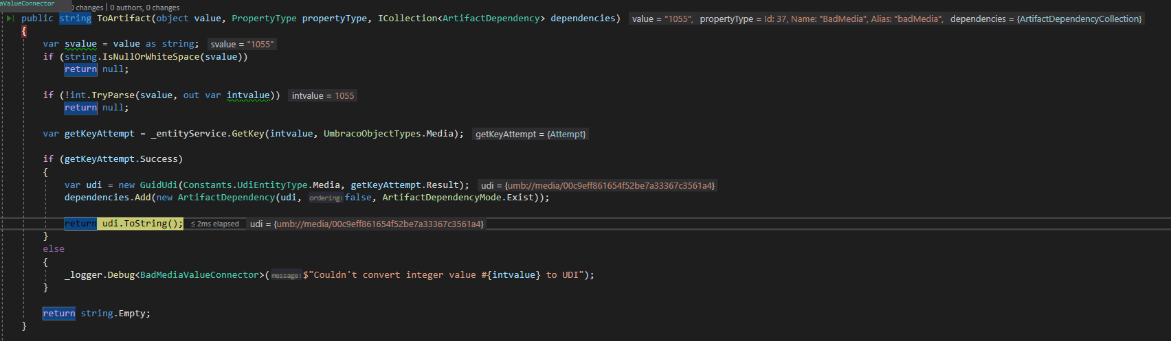

    When stepping through the code we can see that everything seems to work fine:
    Stepped through code
    Note: Showing the variable values is a feature of ReSharper .
    By the time we hit FromArtifact value of "umb://media/00c9eff861654f52be7a33367c3561a4" all that is left to do is convert back to an int.
