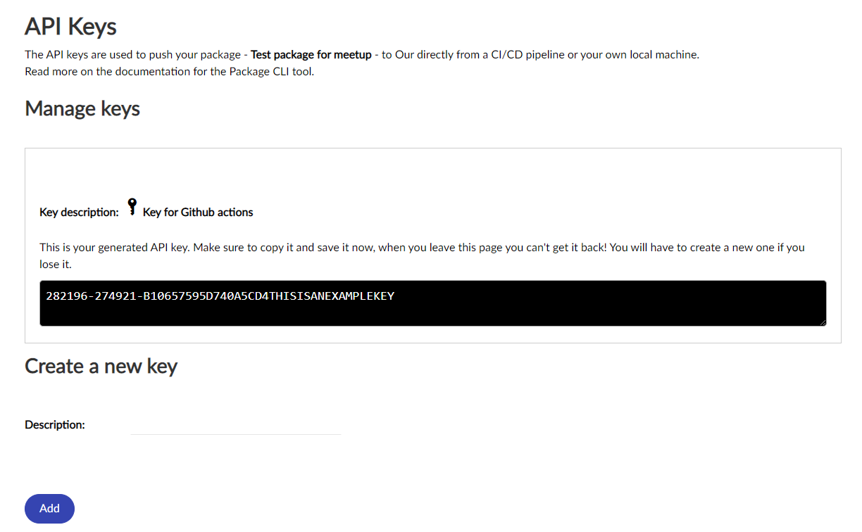

    Creating an API key on Our.umbraco.com
    Before you can start using the UmbPack tool, you need to create the package on Our. Once it has been set up you will then be able to add new versions of the package zip files using UmbPack.
    To create an API key to use with the UmbPack tool you should first log in with your user and go to the manage packages section. There you will find a button under each package to manage API keys:
    Api keys button
    To generate a key, you need to add a description. When you click "Add" it will show you your key. Be aware that as soon as you refresh the page the key will be gone, and if you lose it you will have to generate a new one.
    Example key
    Once you copy the key one more step is needed in order to start using it: you must set up the UmbPack tool.

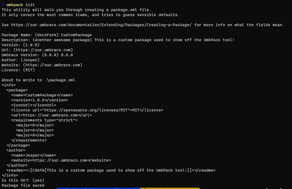

    The Init command
    The init command helps you create a package.xml file, which is the file in an Umbraco package that contains all the metadata for a package - things like author info, version compatibility, etc. The init command can be used by typing:
    umbpack init
    It is usually used to scaffold a package.xml file that you can then use with the pack command to create an Umbraco package.
    Here is an example of what it will look like in the commandline. It will also post back the package.xml for verification at the end:
    UmbPack init example

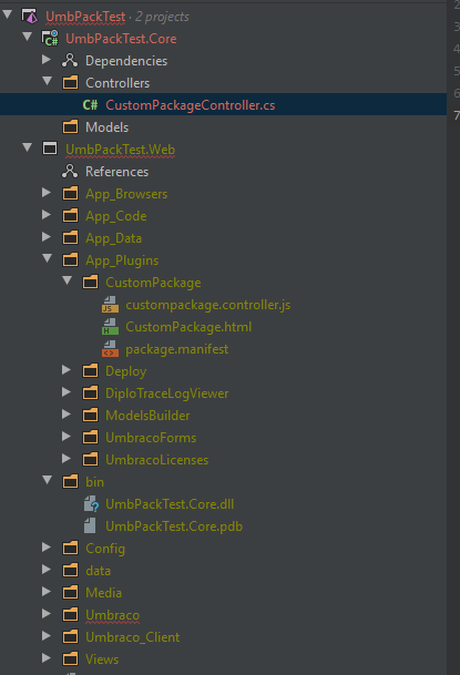

    Let's say you have a solution that looks like this:
    Solution setup
    There is a .Web project and a .Core project. We have a controller in the .Core project that gets built into a dll in the .Web project, so the package files we would want to include are in the .Web project:
    ~/App_Plugins/CustomPackage
    ~/bin/UmbPackTest.Core.dll
    In that case you can add a bit of special xml to the package.xml file that the UmbPack tool can recognize to include it all in the package files:

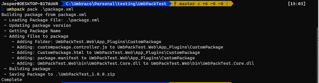

    We can specify a folder and a file (or add additional xml elements for additional files), and when you then run the command targetting a package.xml file in the root of the solution:
    UmbPack pack command
    You will have a zipped version of the package in the location you ran the tool (otherwise you can specify an output location -o). And it will have rewritten the file info to be valid package file info:
