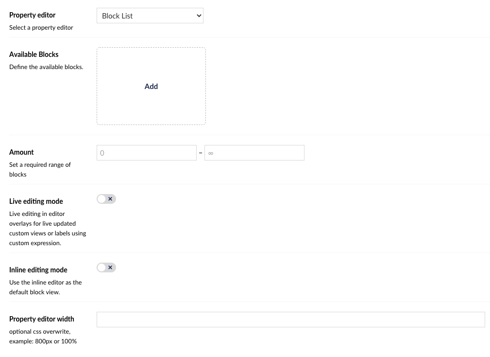

    To set up your Block List Editor property, create a new Data Type and select Block List from the list of available property editors.
    Then you will see the configuration options for a Block List as shown below.
    Block List - Data Type Definition
    The Data Type editor allows you to configure the following properties:
    • Available Blocks - Here you will define the Block Types to be available for use in the property. Read more on how to set up Block Types below.
    • Amount - Sets the minimum and/or maximum number of blocks that should be allowed in the list.
    • Live editing mode - Enabling this will make editing of a block happening directly to the document model, making changes appear as you type.
    • Inline editing mode - Enabling this will change editing experience to inline, meaning that editing the data of blocks happens at sight as accordions.
    • Property editor width - Overwrite the width of the property editor. This field takes any valid css value for "max-width".

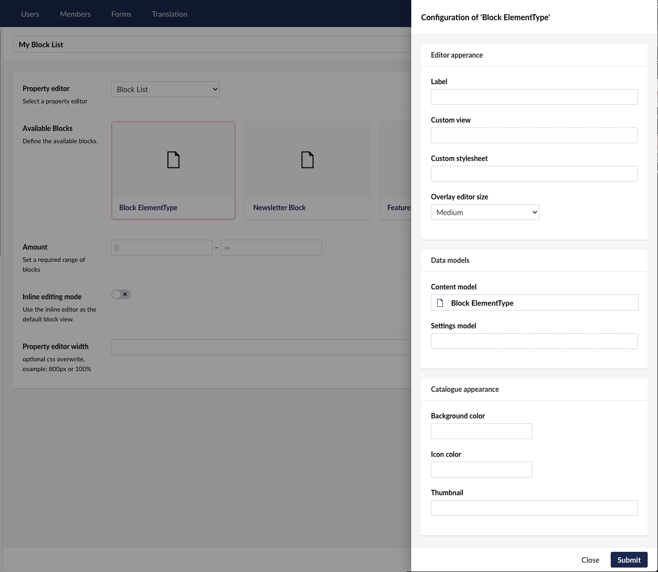

    Setup Block Types
    Block Types are Element Types which need to be created before you can start configuring them as Block Types. This can be done either directly from the property editor setup process, or you can set them up beforehand and add them to the block list after.
    Once you have added an element type as a Block Type on your Block List Data Type you will have the option to configure it further.
    Block List - Data Type Block Configuration
    Each Block has a set of properties that are optional to configure. They are described below.
    Editor Appearance
    By configuring the properties in the group you can customize the user experience for your content editors when they work with the blocks in the Content section.
    • Label - Define a label for the appearance of the Block in the editor. The label can use AngularJS template string syntax to display values of properties. Example: "My Block {{myPropertyAlias}}" will be shown as: "My Block FooBar". You can also use more advanced expression using AngularJS filters, e.g. {{myPropertyAlias | limitTo:100}} or for a property using Richtext editor {{myPropertyAlias | ncRichText | truncate:true:100}}.
    • Custom view - Overwrite the AngularJS view for the block presentation in the Content editor. Use this to make a more visual presentation of the block or even make your own editing experience by adding your own AngularJS controller to the view.
    • Custom stylesheet - Pick your own stylesheet to be used for this block in the Content editor. By adding a stylesheet the styling of this block will become scoped. Meaning that backoffice styles are no longer present for the view of this block.
    • Overlay editor size - Set the size for the Content editor overlay for editing this block.
    Data Models
    It is possible to use two separate Element Types for your Block Types. Its required to have one for Content and optional to add one for Settings.
    • Content model - This presents the Element Type used as model for the content section of this Block. This cannot be changed, but you can open the Element Type to perform edits or view the properties available. Useful when writing your Label.
    • Settings model - Add a Settings section to your Block based on a given Element Type. When picked you can open the Element Type or choose to remove the settings section again.

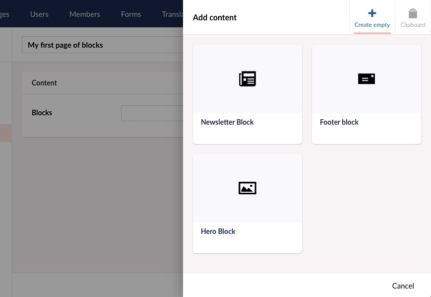

    When viewing a Block List editor in the Content section for the first time, you will be presented with the option to Add content.
    Block List - Add Content
    Clicking the Add content button brings up the Block Catalogue.

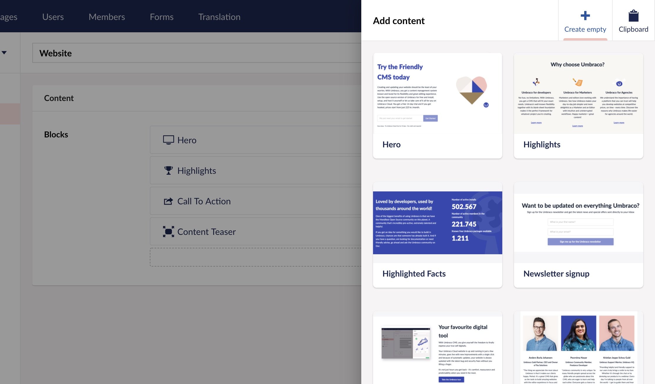

    Block List - Setup
    The Block Catalogue looks different depending on the amount of available Blocks and their catalogue appearance.
    Block List - example setup from Umbraco.com

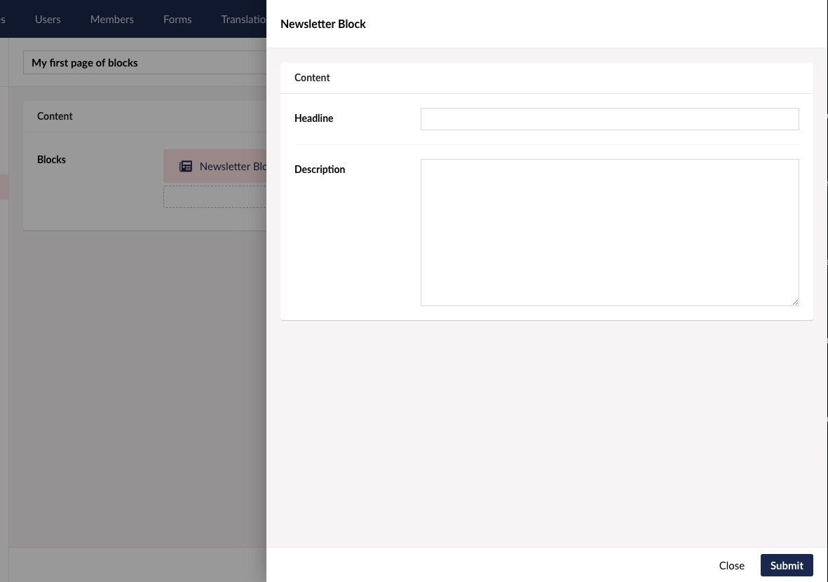

    Click the Block Type you wish to create and a new Block will appear in the list.
    Depending on whether your Block List Editor is setup to use default or inline editing mode you will see one of the following things happening:
    In default mode you will enter the editing overlay of that Block:

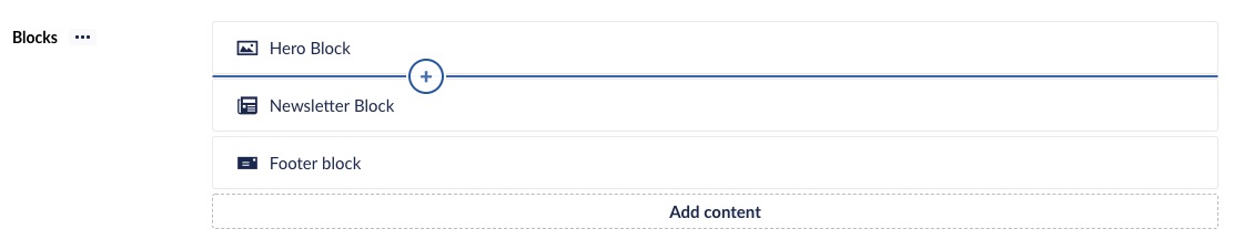

    More Blocks can be added to the list by clicking the Add content button or using the inline Add content button that appears on hover between or above existing Blocks.
    To reorder the Blocks, click and drag a Block up or down to place in the desired order.
    To delete a Block click the trash-bin icon appearing on hover.
