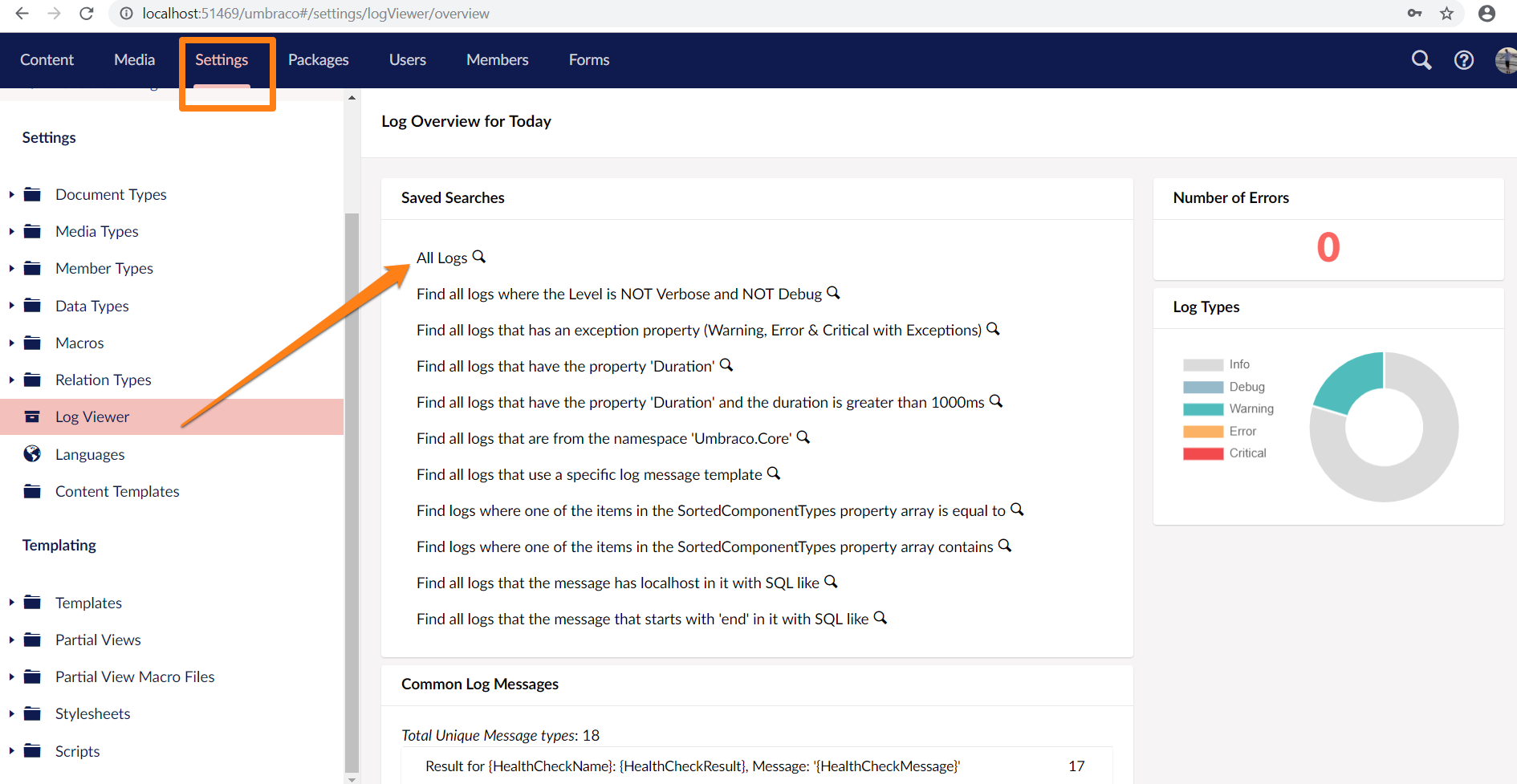

    Now go to the Umbraco backoffice and publish a piece of content. Switch to the Settings section and find the Log Viewer in the Settings tree:
    Log Viewer

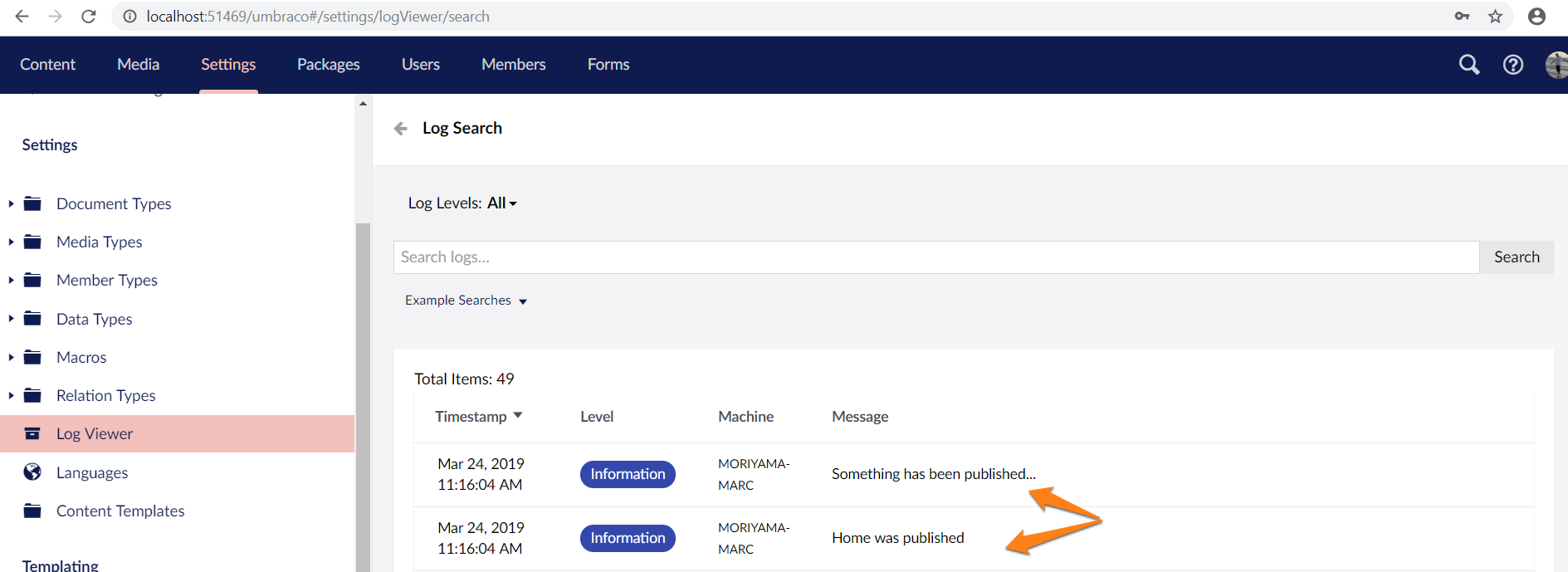

    Search 'All Logs', and if all is wired up correctly you should discover your custom publish log message entries:
    Messages in Log
