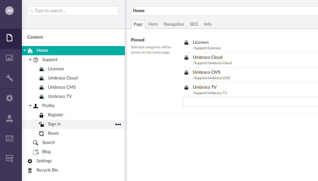

    It is a basic site, with a bit of content:
    v7 site with content

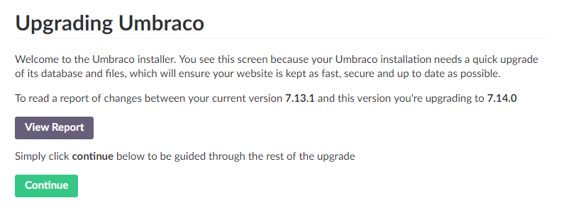

    Following the general upgrade instructions we will now upgrade via Nuget until we get to this point:
    Upgrading to v7.14

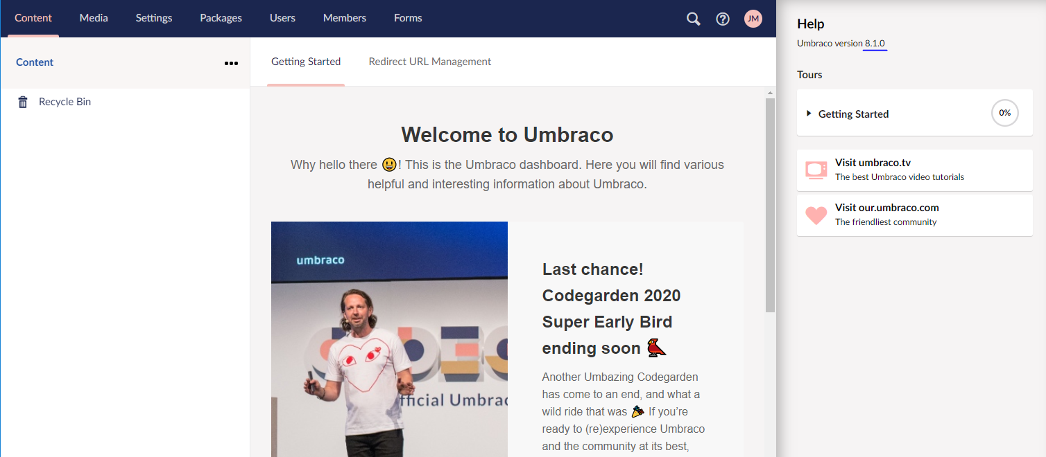

    First thing to do is spin up a fresh new Umbraco 8.1+ site. Make sure it all works and that no content is there (hint: choose not to install starter kit).
    Fresh 8.1 site

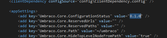

    Once the connection string is set, the final step is to change the Umbraco version number in the web.config on the Umbraco 8.1 site, to say 7.14.0. This will indicate to the site that there is an upgrade pending as the Umbraco dlls are 8.1 but the config says 7.14.0, so it needs to run the migration.
    Set Umbraco version in the web.config
    As you can see in the screenshot, the version will be set to 8.1.0, and you will need to change it to the version you are currently migrating from.

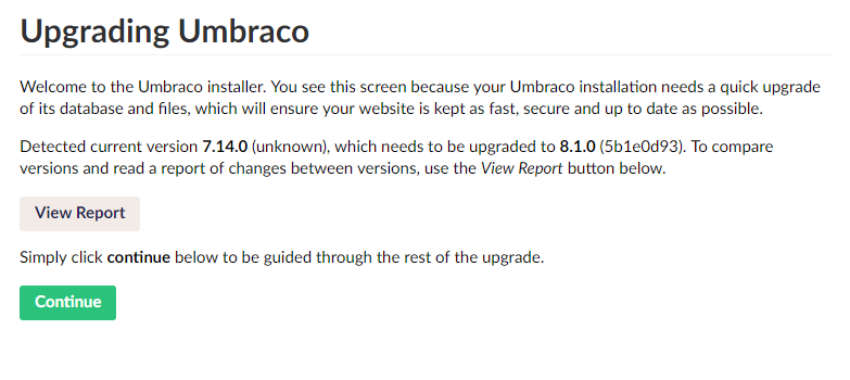

    When you start the site it will ask you to login and then show you this screen:
    Upgrade database to 8.1

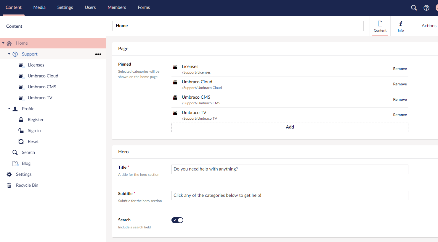

    That is all! Now the automatic migration will take over, and after a little bit you can log in and see your content:
    Content is on 8.1
