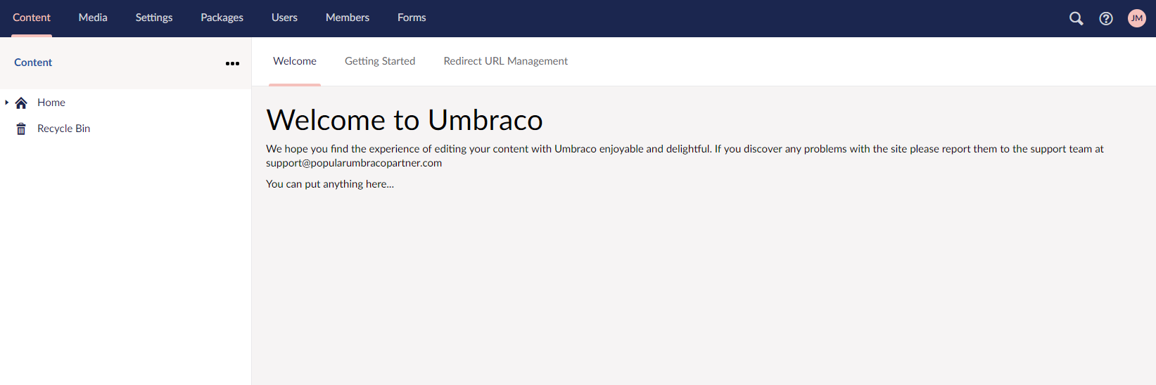

    Creating the dashboard view
    Next, we will create a HTML file inside this folder called 'WelcomeDashboard.html'. The html file will contain a fragment of a html document and does not need <html><head><body> entities.
    Add the following html to the WelcomeDashboard.html
    <div class="welcome-dashboard">
        <h1>Welcome to Umbraco</h1>
        <p>We hope you find the experience of editing your content with Umbraco enjoyable and delightful. If you discover any problems with the site please report them to the support team at <a href="mailto:">support@popularumbracopartner.com</a></p>
        <p>You can put anything here...</p>
    </div>

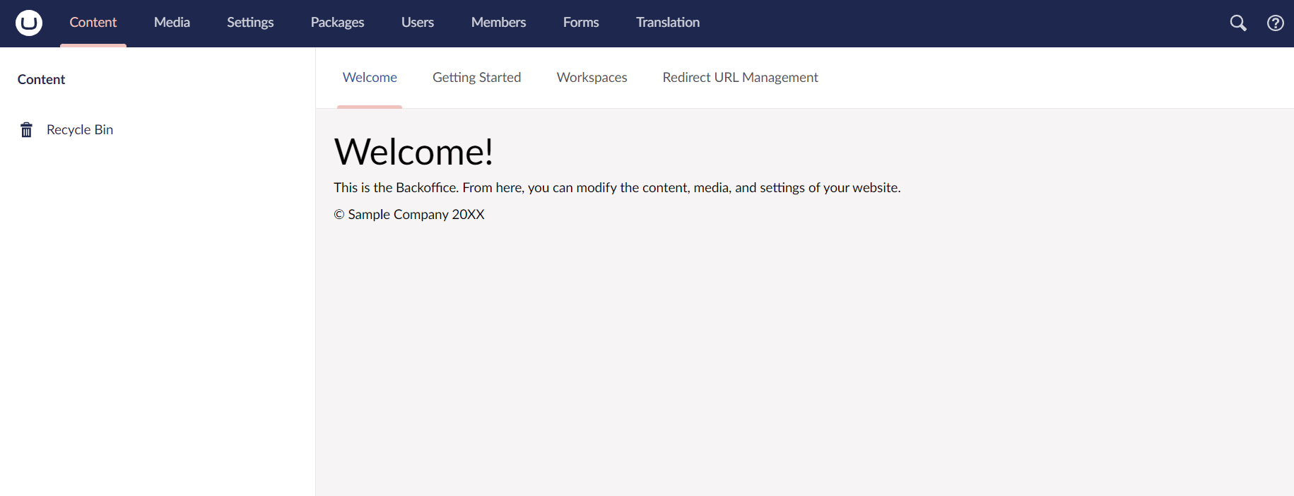

    The Result
    Custom Dashboard Welcome Message
    We can apply the same workflow to elements inside the dashboard, not only the name/alias. Extend the translation file xml like so:

    We are adding another area tag with a few keys. Let us adjust the dashboard HTML accordingly:
        <h1><localize key="welcomeDashboard_heading">Default heading</localize></h1>
        <p><localize key="welcomeDashboard_bodytext">Default bodytext</localize></p>
        <p><localize key="welcomeDashboard_copyright">Default copyright</localize></p>
    </div>
    The localize tag will be replaced with the translated keywords. In the above example, we have some default text inside those tags, which might as well be removed - it would usually not be visible after the translation is applied.
    As for the localize tag syntax in HTML, the area alias is combined with the key alias - so if you want to translate:
    The xml for that specific key will look like this:
    	<area alias="welcomeDashboard">
    		<key alias="heading">Welcome!</key>
    	</area>
    The area and key aliases are combined and an underscore is added inbetween.
    Dashboard with translation keys
    If you don't see the brackets disappearing - you may need to restart the website.

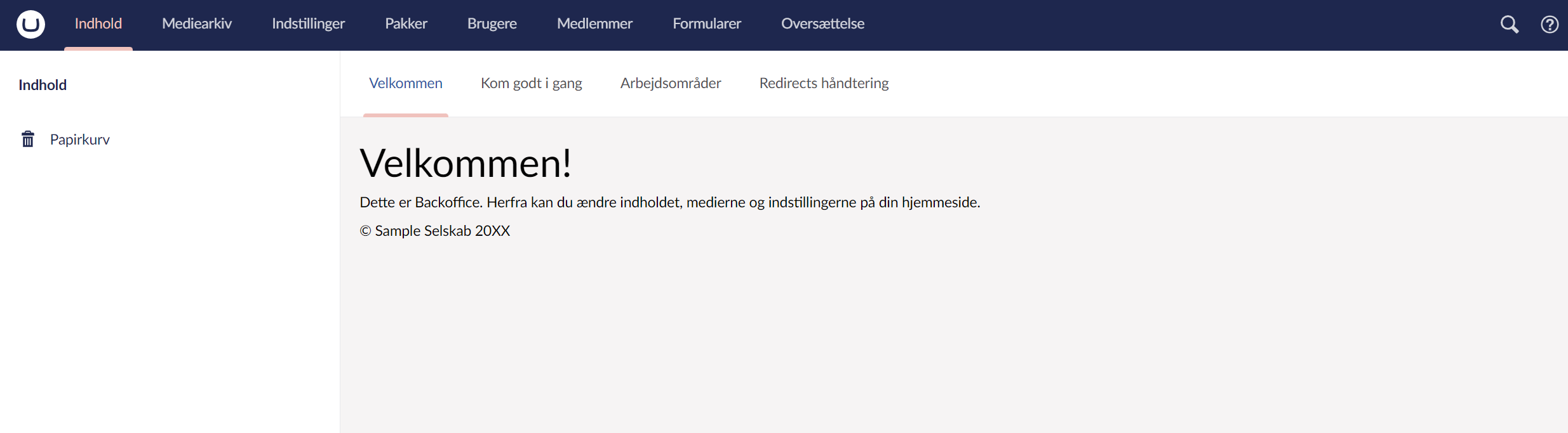

    Different languages
    With the above steps completed, your dashboard is all set up to be translated across different backoffice languages. To test it out, you could, for example, add another language XML file, like da.xml for the Danish language.
    <?xml version="1.0" encoding="utf-8" standalone="yes"?>
    <language>
    	<area alias="dashboardTabs">
    		<key alias="welcomeDashboard">Velkommen</key>
    	</area>
    		<key alias="heading">Velkommen!</key>
    		<key alias="bodytext">Dette er Backoffice. Herfra kan du ændre indholdet, medierne og indstillingerne på din hjemmeside.</key>
    		<key alias="copyright">© Sample Selskab 20XX</key>
    	</area>
    </language>

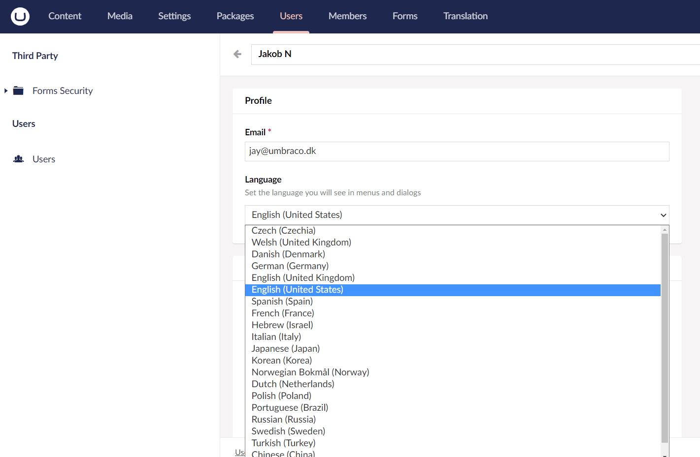

    The backoffice language can be changed in the Users section, if you wish to test out the translations.
    Changing backoffice language
    Dashboard in danish

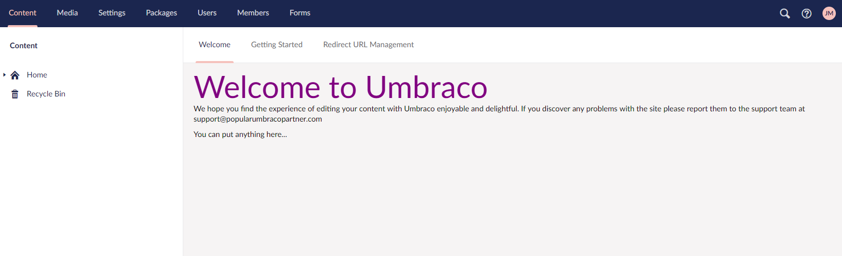

    This stylesheet will now be loaded and applied to your dashboard. Add images and html markup as required.
    Custom Dashboard Welcome Message With styles...
    One caveat is that the package.manifest file is loaded into memory when Umbraco starts up. If you are adding a new stylesheet or JavaScript file you will need to start and stop your application for it to be loaded.
    For version 9 and above: If the title doesn't change color, Smidge may be caching the CSS and JavaScript. To clear the cache and get it to load in the new JavaScript and CSS, you can configure the Runtime minification settings in the appsettings.json file. When you reload the page, you'll see the colorful title.
    For information on creating bundles of your site's CSS or JavaScript files in your code, see the Bundling & Minification for JavaScript and CSS section.
    For version 8 and below: If the title doesn't change colour, you may be running the site without debugging and therefore ClientDependency Framework (CDF) will be caching the CSS and JavaScript. To clear the CDF cache and get it to load in the new JavaScript and CSS, you need to increment the version number in the ClientDependency.config file and press save. Now you can reload the page and see the colourful title.
    Hopefully, now you can see the potential of what you could provide to an editor as a basic welcome dashboard when they log in to Umbraco.

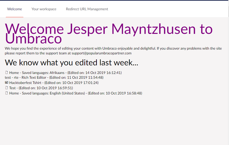

            vm.UserName = user.name;
    Notice you can use console.log to write out to the browser console window what is being returned by the promise, it helps to debug, but also understand what properties are available to use.
    Finally we can now update our view to incorporate the current user's name in our Welcome Message:
    <h1><localize key="welcomeDashboard_heading">Default heading</localize> {{vm.UserName}}</h1>
    Custom Dashboard Welcome Message With Current User's Name

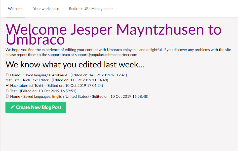

    I know what you did last Tuesday
    A returning editor may find it useful to see a list of the last few articles they have been editing, with a handy link to load and continue editing. This could be instead of having to remember, and find the item again in the Umbraco Content Tree.
    We can make use of Umbraco's Angular resource for retrieving audit log information, the logResource using the getPagedUserLog method to return a list of activities the current user has performed recently.
    We inject the logResource into our controller:
    angular.module("umbraco").controller("CustomWelcomeDashboardController", function ($scope, userService, logResource) {
    Add a property on our ViewModel to store the log information:
    vm.UserLogHistory = [];
    Add to our WelcomeDashboard.html view some markup using angular's ng-repeat to display a list of these log entries:
    <h2>We know what you edited last week...</h2>
    <ul>
        <li ng-repeat="logEntry in vm.UserLogHistory.items">{{logEntry.nodeId}} - {{logEntry.logType}} - {{logEntry.timestamp  | date:'medium'}}</li>
    </ul>
    Back in our controller we'll populate the array of entries using the logResource, the getPagedUserLog method expects to receive a JSON object containing information to filter the log by:
    var userLogOptions = {
        pageSize: 10,
        pageNumber: 1,
        orderDirection: "Descending",
        sinceDate: new Date(2018, 0, 1)
    These options should retrieve the last ten activities for the current user in descending order since the start of 2018, we pass the options into the getPagedUserLog like so:
    logResource.getPagedUserLog(userLogOptions)
        .then(function (response) {
            console.log(response);
            vm.UserLogHistory = response;
    Take a look at the output of console.log of the response in your browser to see the kind of information retrieved from the log:
    {pageNumber: 1, pageSize: 10, totalPages: 1, totalItems: 1, items: Array(1)}
        items: Array(1)
            0:
                $$hashKey: "object:1289"
                comment: "Published languages: English (United States)"
                entityType: "Document"
                logType: "PublishVariant"
                nodeId: 1055
                parameters: "English (United States)"
                timestamp: "2019-10-10T14:49:55.223Z"
                userAvatars: []
                userId: 1
                userName: "Jakob N"
        pageNumber: 1
        pageSize: 10
        totalItems: 1
        totalPages: 1
    It's nearly all we need but missing information about the item that was saved and published!
    We can use the entityResource, another Umbraco Angular resource to enables us to retrieve more information about an entity given its id.

    Finally update our view to use the additional retrieved entity information:
    <ul class="unstyled">
            <i class="{{logEntry.Content.icon}}"></i> <a href="/Umbraco/#/{{logEntry.editUrl}}">{{logEntry.Content.name}} <span ng-if="logEntry.comment">- {{logEntry.comment}}</span></a> - <span class="text-muted">(Edited on: {{logEntry.timestamp  | date:'medium'}})</span>
        </li>
    </ul>
    and we should have a list of recently saved content and media:
    The url /umbraco/#/content/content/edit/1234 is the path to open up a particular entity (with id 1234) ready for editing.
    The logResource has a few bugs prior to version 8.1.4, so if you are on a lower version this may not give the expected result.
    I know what you want to do today
    One of the key user journeys an editor will make in the backoffice is to create a new thing of some sort. If it is a person's job to create new blog entries in the same section two or three times a day, why not create them some handy shortcuts to achieve these common tasks?
    We could add a shortcut to allow the users to add one of the most common type of pages they would be working with, like a blogpost.
    Add the following to our view:
    <div>
        <a class="btn btn-primary btn-large" href="/umbraco/#/content/content/edit/1065?doctype=BlogPost&create=true">
            <i class="icon-edit"></i>
            Create New Blog Post
        </a>
    </div>
    Where 1065, is the id of our blog section, and BlogPost is the alias of the type of document we want to create.
