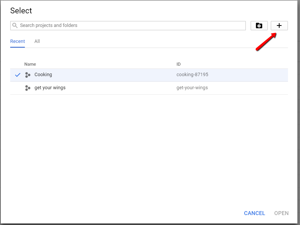

    The first thing to do is to add a new API, you may have some already if you are using Firebase or any other Google product, but click the + at the top:
    Add new API

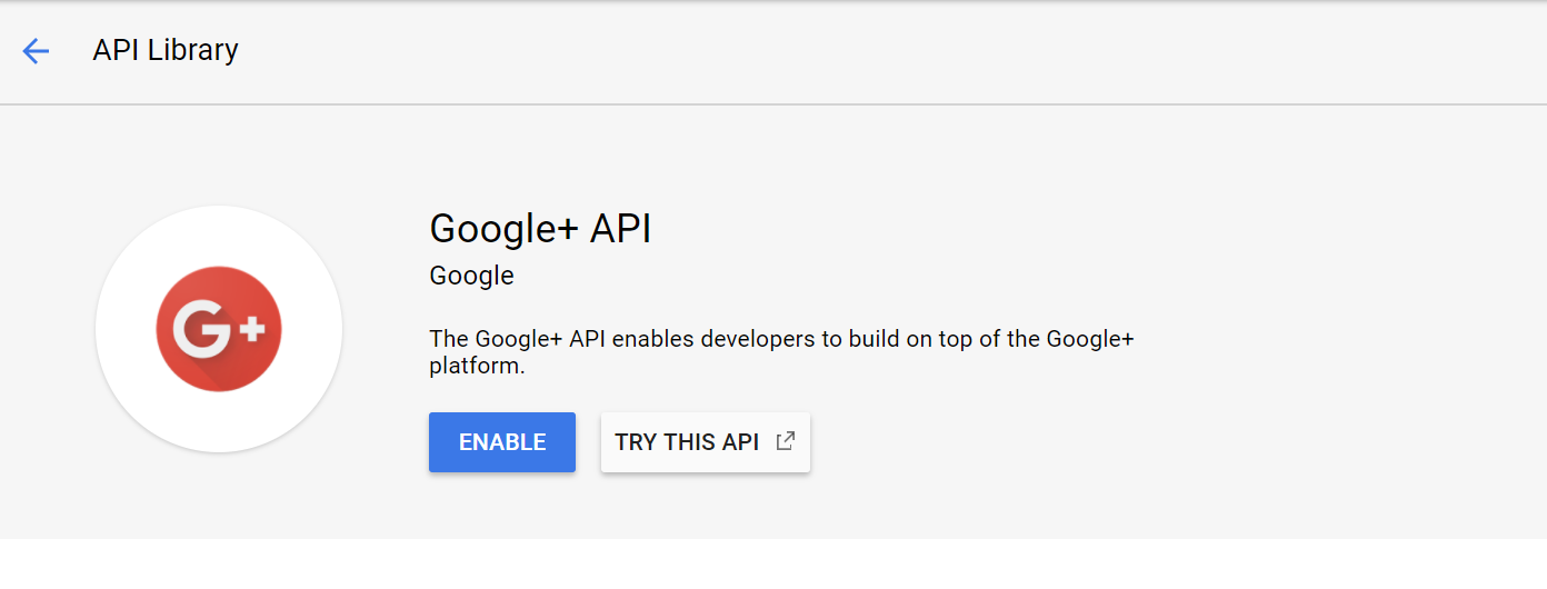

    After you have given your new API a name and gone through the basic setup you need to add an API from the API library on the lefthand menu. Find the Google+ API and enable it:
    Add Google Plus API

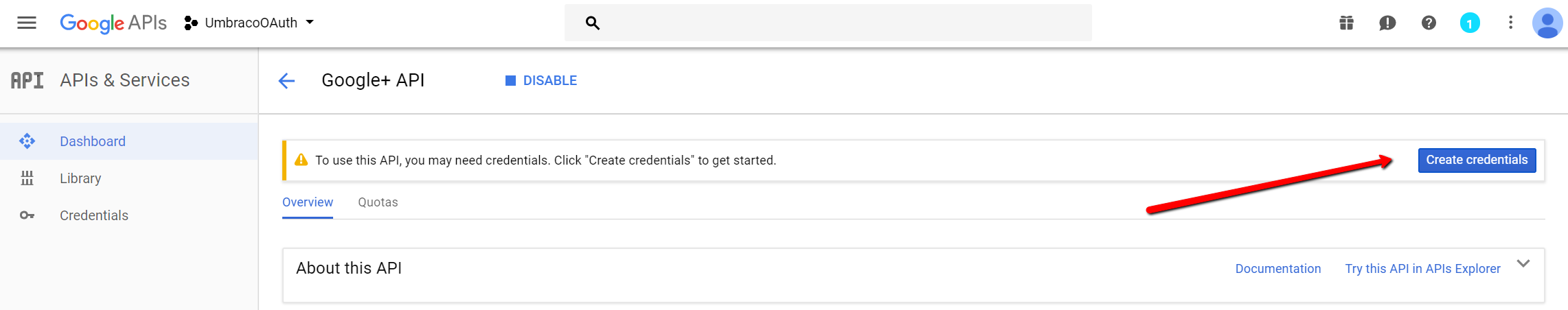

    Once you have enabled your new API, you will need credentials. Click on the button and fill in the info as below:
    Create Credentials Fill out credentials
    Add in your credentials and the domains that it should cover. As you can see I am using an Umbraco Cloud page and have chosen the path domain/google-signin as the redirect URL.
    Now, fill in your email and leave the page open - you will need the Client ID and Client Secret in a little while!

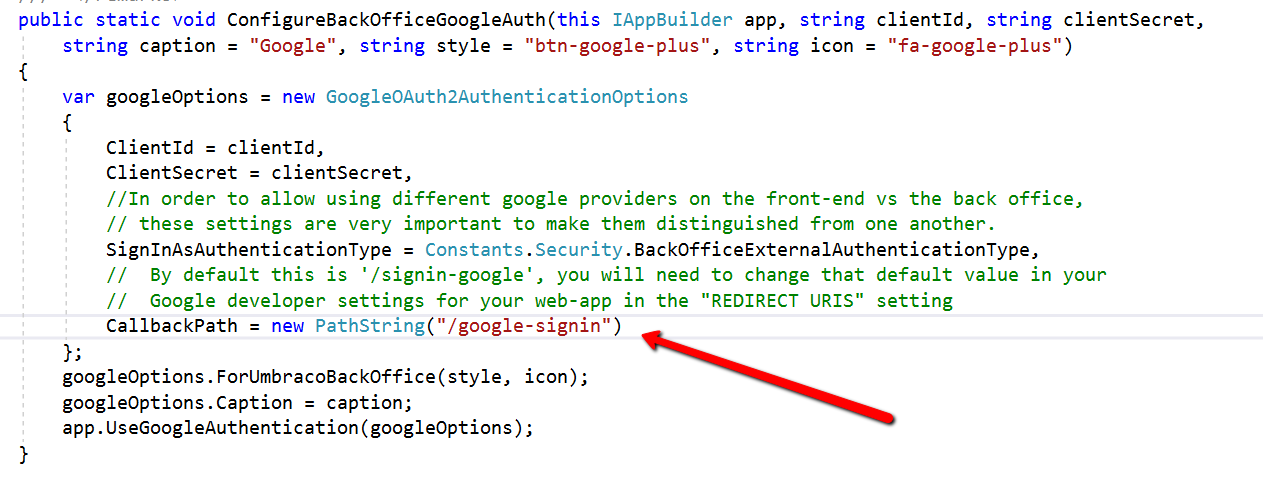

    The first thing to do is locate the files we installed from the packages. They are located in the App_Code/App_start folder. There are two files we need to edit, first one is the file called UmbracoGoogleAuthExtensions.cs. The only thing you need to touch here is the callback path, this is what we set on the API as the redirect URL. If you followed my example it should be set to /google-signin:
    Callback path

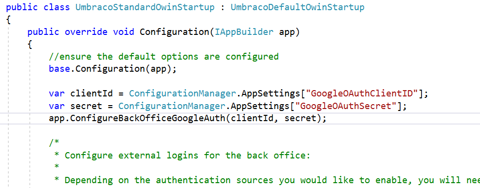

    The second file we need to configure is the UmbracoStandardOwinStartup.cs file. Here we need to add the following code:
    var clientId = ConfigurationManager.AppSettings["GoogleOAuthClientID"];
    var secret = ConfigurationManager.AppSettings["GoogleOAuthSecret"];
    app.ConfigureBackOfficeGoogleAuth(clientId, secret);
    Add this in the file as seen here:
    Set client info
    The ConfigurationManager is missing a dependency so add the following at the top: using System.Configuration;

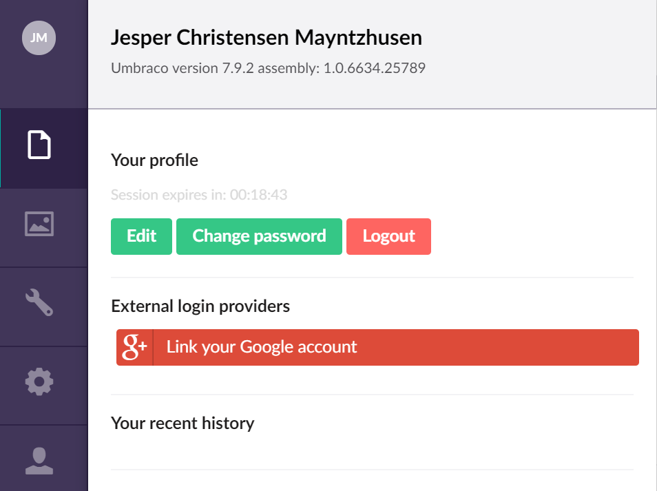

    Build and run the website one final time. Now when you have logged into your backoffice you can click your user in the top right corner and choose link with Google:
    link Google
    If you do that, then in all future backoffice logins you will have a button like at the top of this guide that you can click and you are logged in!
