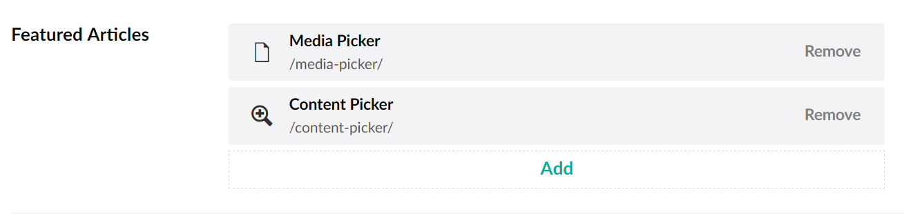

    Content Example
    Multinode Treepicker
