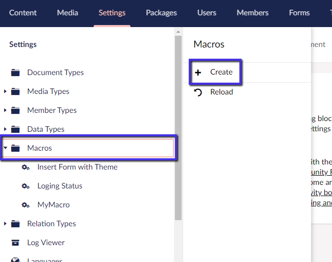

Manually
The first way is to manually create a macro, by right-clicking the Macro folder in the Settings section:
Give it a name in the dialog screen, and you'll be presented with the macro editor.

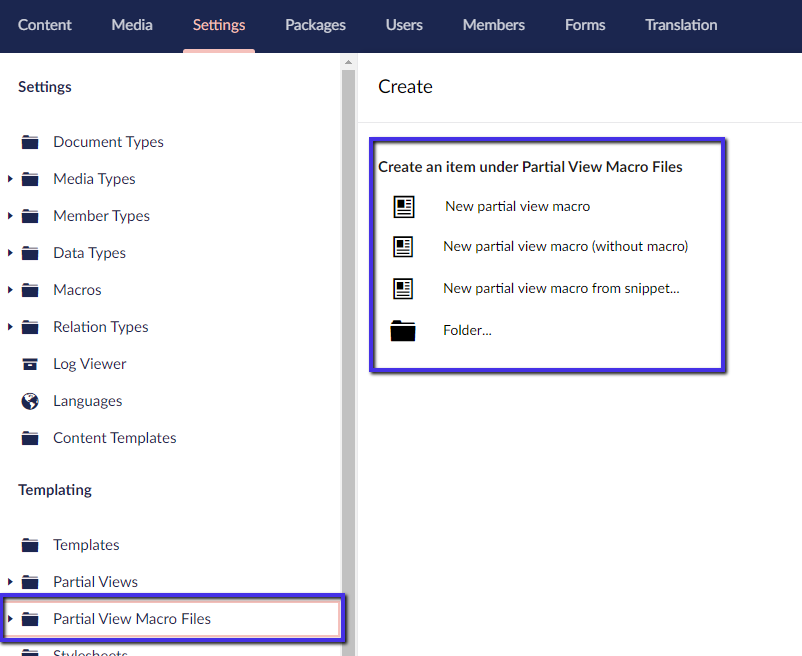

Partial View Macro files
The second option is to create the macro through Partial View Macro Files.
The dialog provides the following options:
- New partial view macro: Will give you an empty macro with an associated empty partial view file
- New partial view macro (without macro): Will give you a partial view, without an associated macro
- New partial view macro from snippet...: Will give you the option to choose between a pre-defined set, including a macro and a partial view with a code snippet
- Folder...: Will give you the option to create a folder below "Partial View Macro Files"

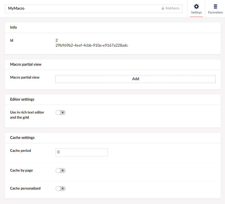

Macro Editor
The macro editor view comes with a set of configuration options.
Macro partial view
Associate the macro with a partial view. This will already have been configured if you created the macro through the second option described above, where a Partial view was created along with the macro.
Editor settings
Use in rich text editor and the grid
If selected will allow an editor to insert this macro in to a Rich Text Editor and/or into a Grid editor.
Caching options
Cache period
Defines how many seconds the macro output will be cached for once it is rendered
Cache by page
If selected, then the macro will be cached based on the current page it is rendered on. This is useful if your macro has content that is dynamic to the current page it is being rendered on. If your macro's output is static (the same) no matter what page it is rendered on then it is better to not check this box.
Cache personalized
Similar to the 'Cache by page', this will cache the output of a macro based on a member that is logged in. If your macro is static (the same) no matter what member is logged in, or if your website does not have membership then it is better to not check this box.

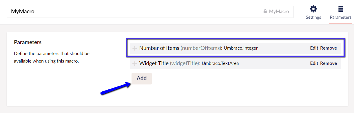

Macro parameters
Macro parameters can be used to change the output of a macro at runtime. Macro parameters are often used as a way for your editors to change the output of a macro when they insert them into rich text editors. As an example, suppose you have a widget that displays a list of links which are children of a particular content item. You could define a macro parameter that indicates for which content item to render child links for and your editor can select this content item when inserting the macro into the rich text editor.
The macro parameter dialog looks like this:
Here you can add/modify/remove macro parameters.
