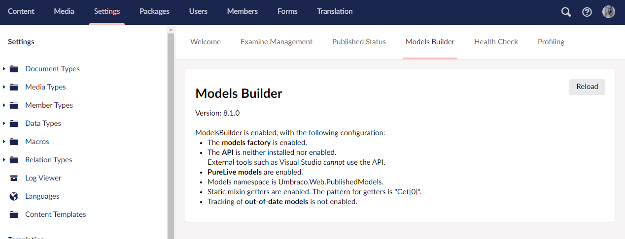

    Models Builder Dashboard
    Models Builder ships with a dashboard in the Settings section of Umbraco's backoffice. The dashboard does three things:
    • Details on how Models Builder is configured
    • Provides a way to generate models (in LiveAppData mode only)
    • Reports the last error (if any) that would have prevented models from being properly generated
